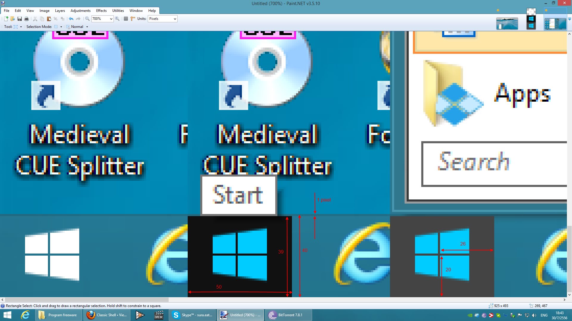

1.1 sometime got problem

41 = 1 pixel overlap
40 = windows logo wrong position with 1 pixel border
39 = only 1 pixel border

Hrm... on my system they align with the bar, not one pixel over or under. If I allow the Windows 8.1 button, and hover the corner, it appears exactly the same as the my CS button. Stock Win 8.1 64bit start bar settings and CS 3.90 on Windows 7 mode.
Also aligns on VMware just fine.
Your button sizes are set to 0?

Just tried the one I posted again, downloaded from this page, It aligns fine and no 1 extra pixel row up top. :/
Tried the 39+39+39 one, its one pixel row too low.
I understand the hight of the bar is 40 but using a 40+40+40 png yeilds miss alignments with the real start button. If you enable the bottom left corner and hover over CS's button and then move to the corner, you can see how a 40 sized one miss aligns by one pixel, that's why I made it 41.
The bar actually seems to be 41 pixels tall with a 1px row hidden off the bottom of the screen. Color the bottom line of each button a noticeable colour like pink. You won't see it if the bar is the standard 1x size, if you double the bar height, you will see it.
At least that's how it all goes down on my computer.
