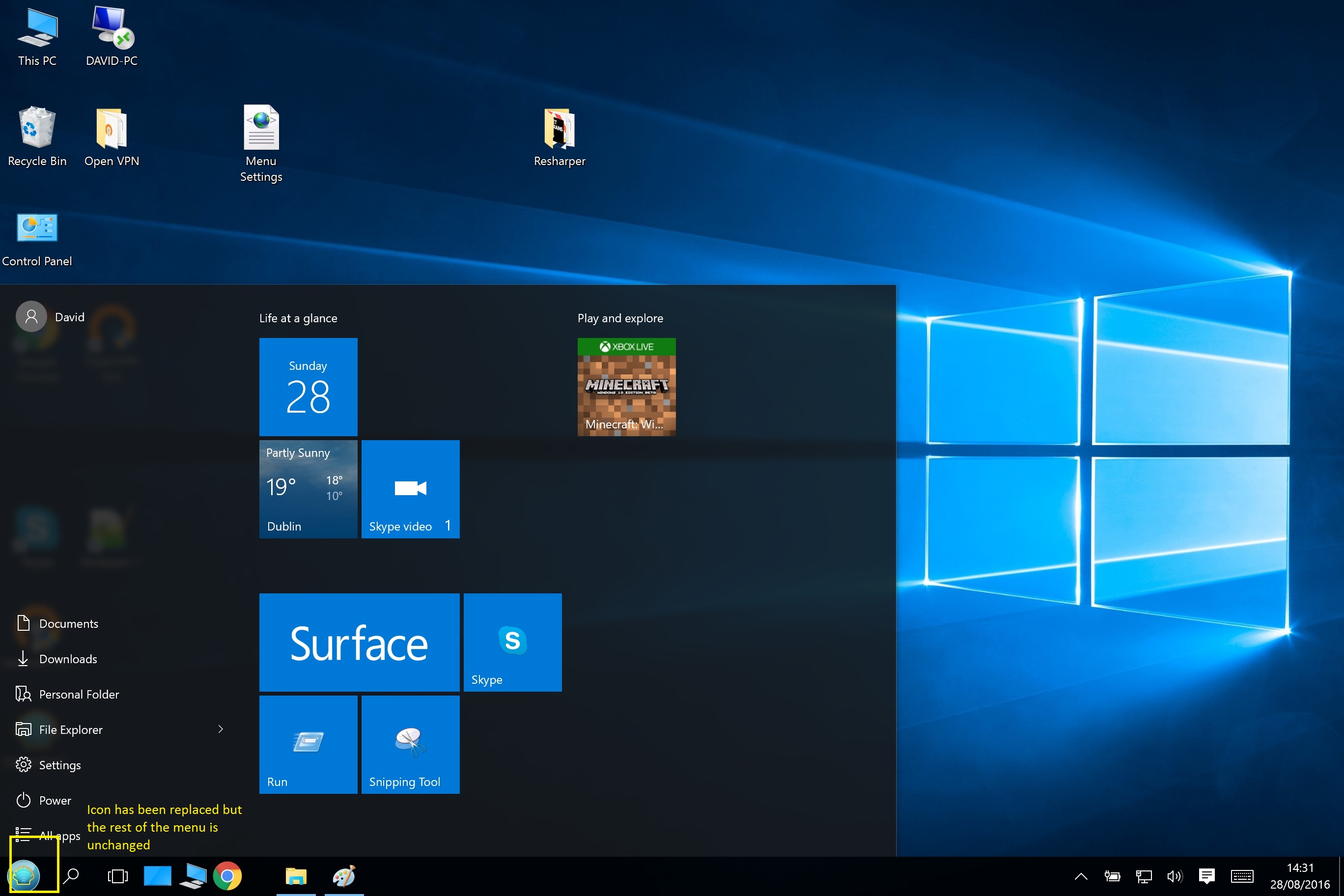

I've just installed ClassicShell 4.3.0 onto a Surface Pro 4 running build 1511.
After the install I was taken to the settings menu and I was able to set the various options that I wanted.
I was also able to specify the icon to replace the default Start Menu icon.
The problem I'm having is that the icon was replaced but not the actual menu content. The attached screenshot might give you a better idea of what I'm trying to say.
Is this a known issue with an easy workaround?

Check your settings for "Windows Key opens" and "Left Click opens" on the Controls tab in Settings. They should be set to Classic Start Menu to use it.
PostPosted: Sun Aug 28, 2016 8:05 am
Joined: Sun Aug 28, 2016 6:35 am
Yip, that was the problem. How stupid do I feel :D
Thanks very much.
