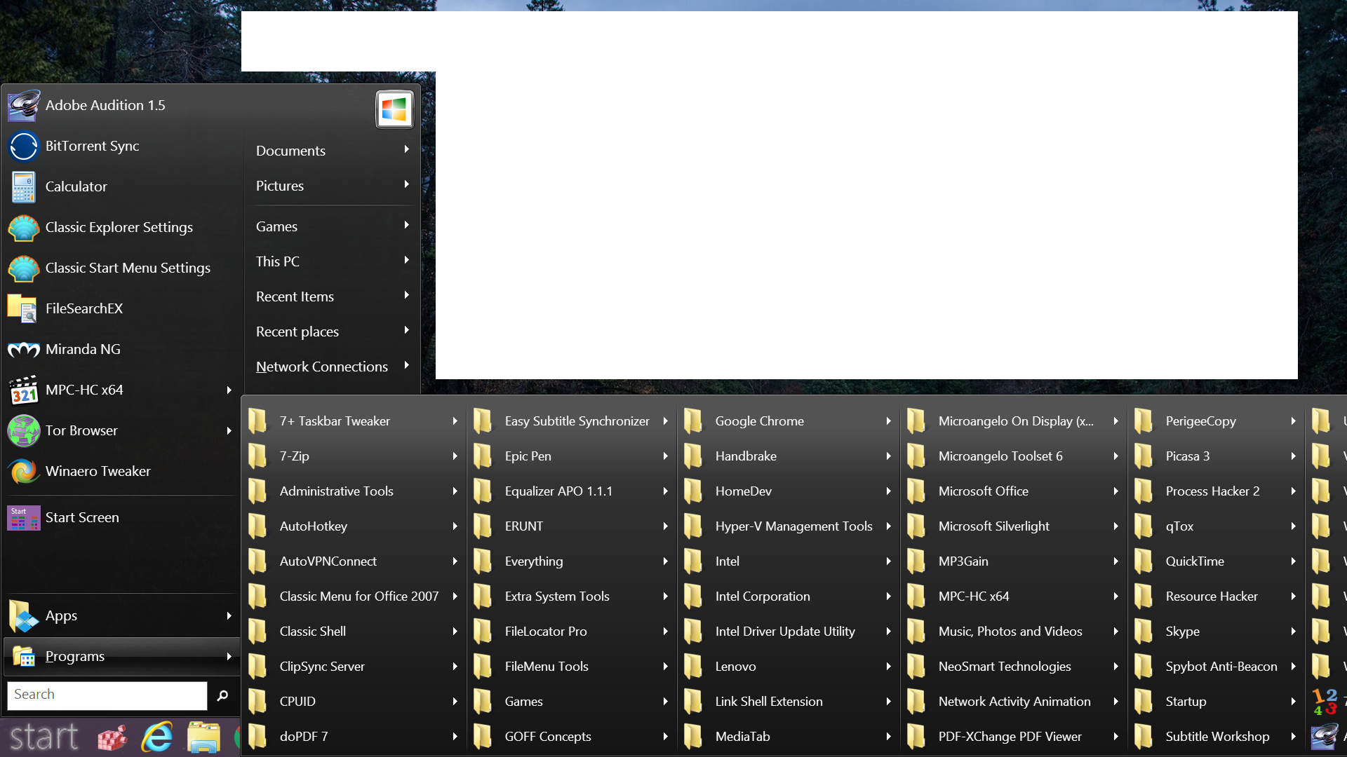

The menu cannot be closed by clicking in the white region (marked in the attached image). While you can split it that way into multiple columns using transparent padding, the only benefit is that you get to see what's behind it. The menu still occupies the area of the screen marked by the white region but you are only hiding it by making it transparent. This is different from actually making the menu not take up that space at all. That's what I meant by "not possible". Technically, you can create a 1 row submenu too with the rest of the area transparent. :D

I tried Smoked Glass2a.skin. It is see-though but the submenu doesn't close for me in the area which I pointed out in Region.png above. How can it? :) It can't because it's transparent, it's not like you modified the Start Menu code to not render it in that area. :)
