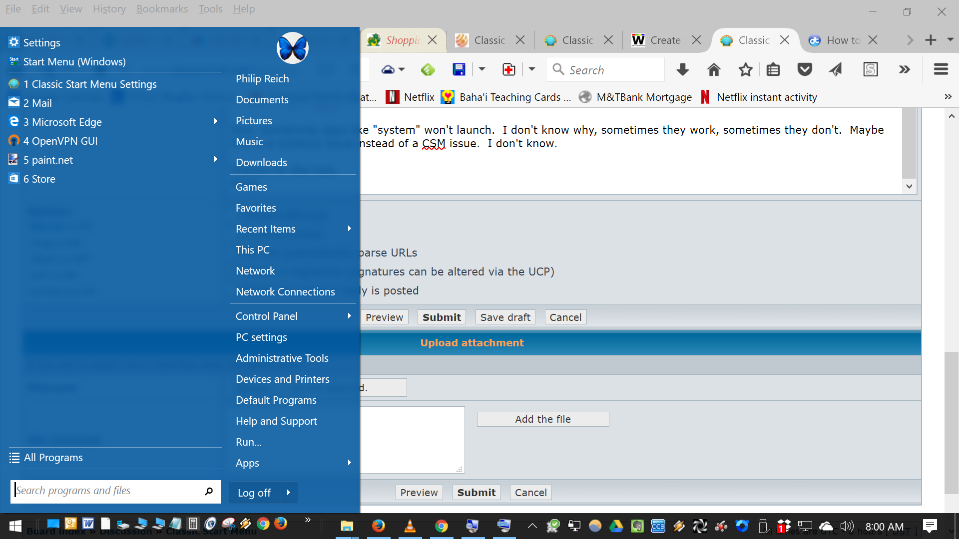

I was just upgraded to the windows creators update 1703. I was having problems with the start menu after it installed, and so I decided to download and install CSM because I was pretty fed up with the windows 10 start menu anyway.
However, after installation, the following occurred:
Instead of seeing a "stutdown" menu, what I see is a "logoff" menu.
I went into the CSM settings, and no matter what shutdown setting I tried to apply, this did not change.
Maybe a clue is that the option to "Show shutdown during remote session" has a lock on it, and says it is disabled due to group policies, but I haven't set any group policies. I am using windows 10 home edition, so I don't have the policy editor....
The settings I have set in the CSM shutdown settings selected are: Shutdown Dialog, and I have put the following commands in the "shutdown menu items" list: "switch_user,logoff,restart,sleep,hibernate,shutdown,lock". I also tried leaving the "shutdown menu items" list blank, which is supposed to default to all options, but that didn't work either.

I have attached a screenshot showing CSM, and also a system log produced by your CSM utility.

File comment: screenshot showing "logoff" instead of "shutdown".
2017-07-17.png [333.39 KiB]

PostPosted: Mon Jul 17, 2017 8:13 am
It sounds like shutting down is disabled for your PC.
If you click on the Desktop, then press Alt+F4, do you see "shut down" in the list?
No, shutdown is not disabled. When I press Alt+F4, it brings up the windows 10 shutdown options.
