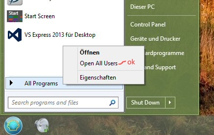

'Open All Users no longer works. Where is the problem? (see picture)
Greetings
 Post subject: Re: Open All Users
PostPosted: Sat Jan 31, 2015 9:59 am
Usually it goes to this folder: C:\ProgramData\Microsoft\Windows\Start Menu
Check if it exists and that you can open it in Explorer manually.

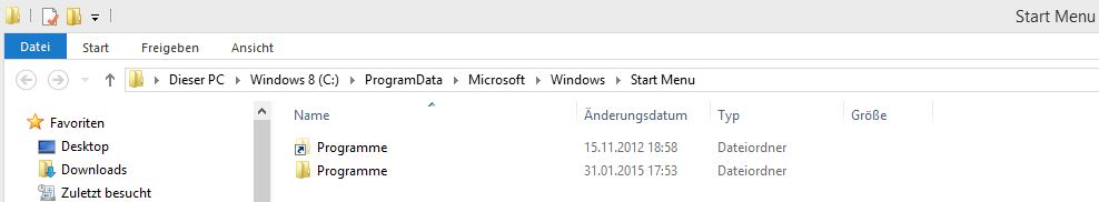

Yes, the call from 'All Programs' works correctly. (see pic 1, pic 2)

Why do you have two "Programme" items in your start menu folder? I suspect there is some mixup with your start menu folders.

Menu 'All Programs' -> 'All Users' no problem

Everything looks OK. If I were you I would investigate that grayed out shortcut called "Programme".

Confirmed, this is a problem caused by installing the AirDroid software. Like Zerpus, I was lucky enough to have used Total Uninstall so I was able to identify how AirDroid caused the problem.
It hijacks the Open All Users command by overwriting the C:\ProgramData\Microsoft\Windows\Start Menu.lnk shortcut with one that points to C:\Program Files (x86)\AirDroid\Launcher.exe
The file is supposed to point to C:\ProgramData\Microsoft\Windows\Start Menu
Uninstalling the software did not correct the issue (it just makes the command stop working altogether as the link target is gone); you need to manually repair the link.
