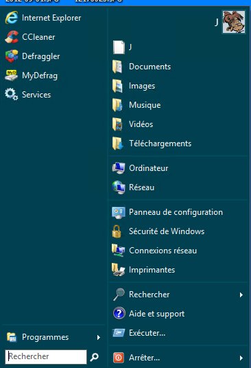

In the Skin option, we can use Large icons instead of small...
But when I choose Large icons, a square is drawed around them...
Is there a way for havin only the icons without the squares ?!?

What skin are you using?
A screenshot would be very helpful.

Skin is Metro
You can see the difference between Small Icons and Big ones
And the squares around the big ones

Yes, this is part of the Metro skin. It was made to match the look of the Metro screen (which has the icon frames).
There is no option to enable or disable the frames. You can edit the skin to remove them. Here's how you edit skins: http://www.classicshell.net/tutorials/skintutorial.html
Remove the line "Main_icon_frame=3" and the frames will go away.
