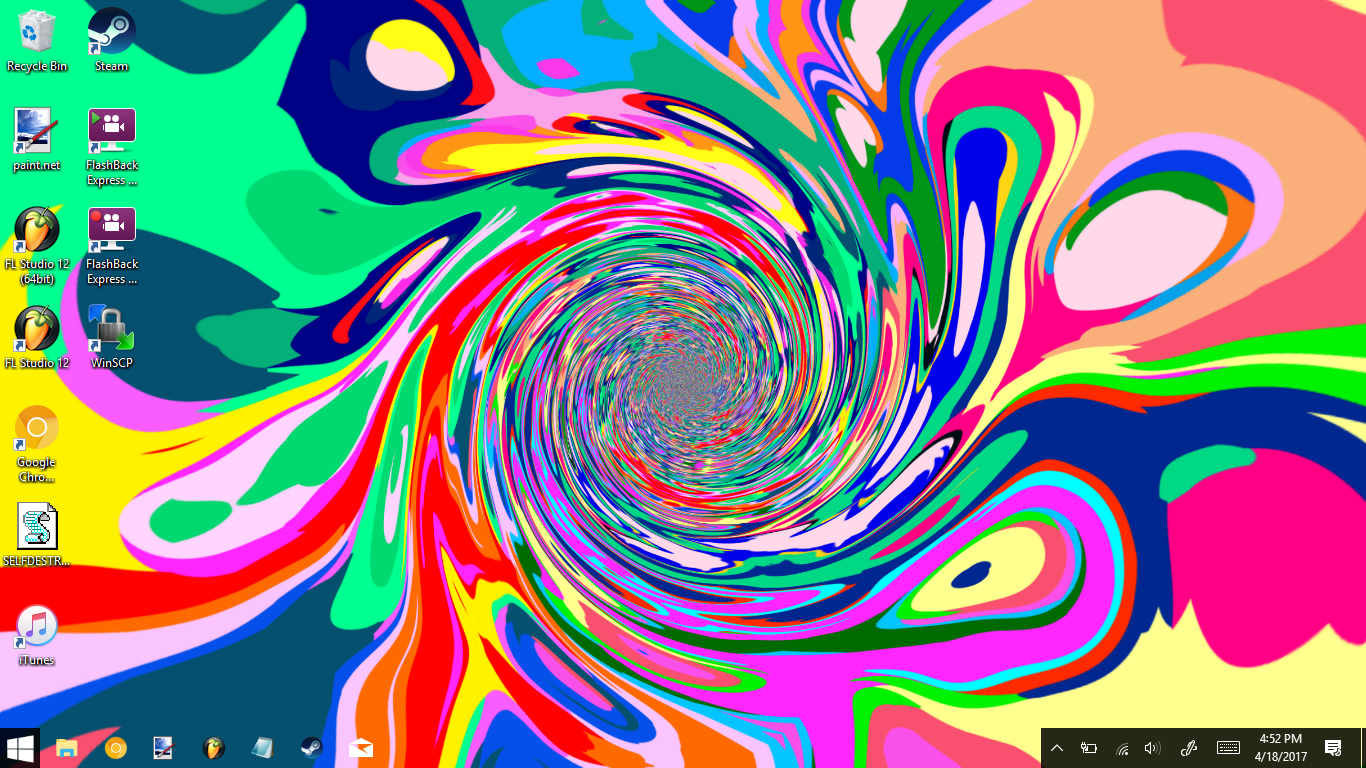

Hello everyone!
I'm having some trouble with Classic Shell today.
My Desktop looks like this:
Can anyone help me?

@AcroGen
Are you using textures in taskbar?
I'm having the same problem with textures.
See: viewtopic.php?f=7&t=7464

Changing the color of the taskbar works fine. It is only a problem if you want to use an image for your taskbar background.
