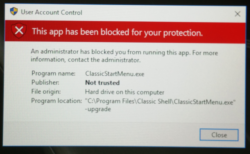

Windows 10 is blocking Classic Shell from working properly.
It gives me this message and I'm a Administrator and have no option to correct it.
John
PostPosted: Wed Jul 20, 2016 4:44 pm
Uninstall Classic Shell, then install the latest stable version 4.2.5c. If you use a pre-release insider version of Windows 10, then use the beta version 4.2.7.
