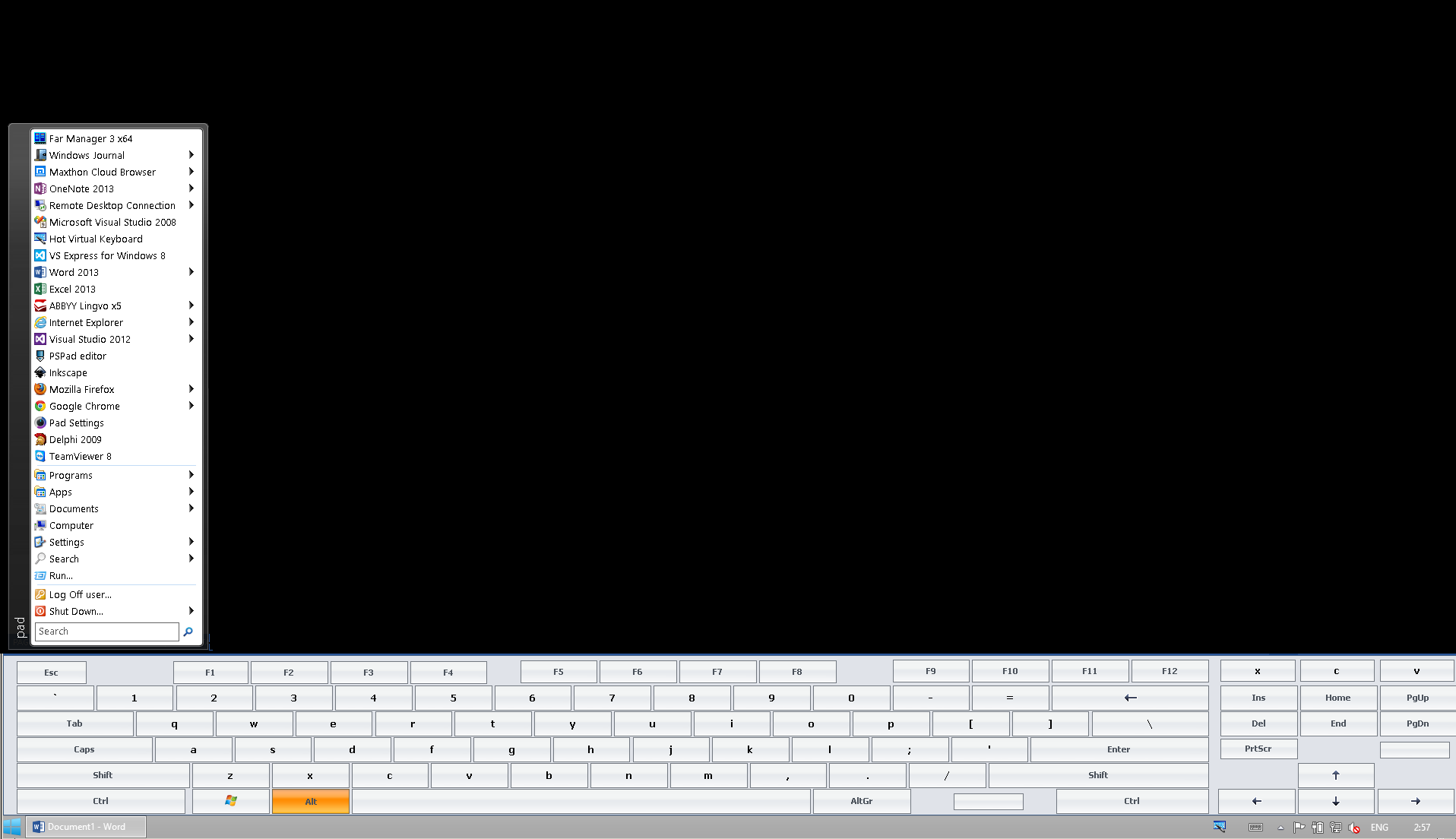

Classic Start Menu does not take into account results of GetMonitorInfo call properly, rcWork part
http://msdn.microsoft.com/en-us/library/windows/desktop/dd145065(v=vs.85).aspx
Some programs, like Hot Virtual Keyboard http://hot-virtual-keyboard.com/ are able to exclude some parts of the screen from working area.
For an example, if you tie up the virtual keyboard to bottom of the screen - all maximized programs take that into account and do not overlap the virtual keyboard by default.
But that is not applicable to Classic Shell Start menu (see screenshot attached).
It's noncritical issue, it's possible to hide/show virtual keyboard in order to show classic menu properly, but the issue is much wide, because other programs can also exclude parts of the screen from working area, while Classic Shell is not able to handle that properly.

Expected befavior is shown on screenshot which is attached below.
Menu should appear straight above the virtual keyboard: bottom coordinate of menu should be less than rcWork.bottom coordinate, on appropriate screen.
That way works original windows Start menu Windows 7/XP: it does not overlap nonworking part of the screen (does not overlap screen parts which are excluded by something that adjust results of GetMonitorInfo() rcWork).
Untitled.png [65.51 KiB]

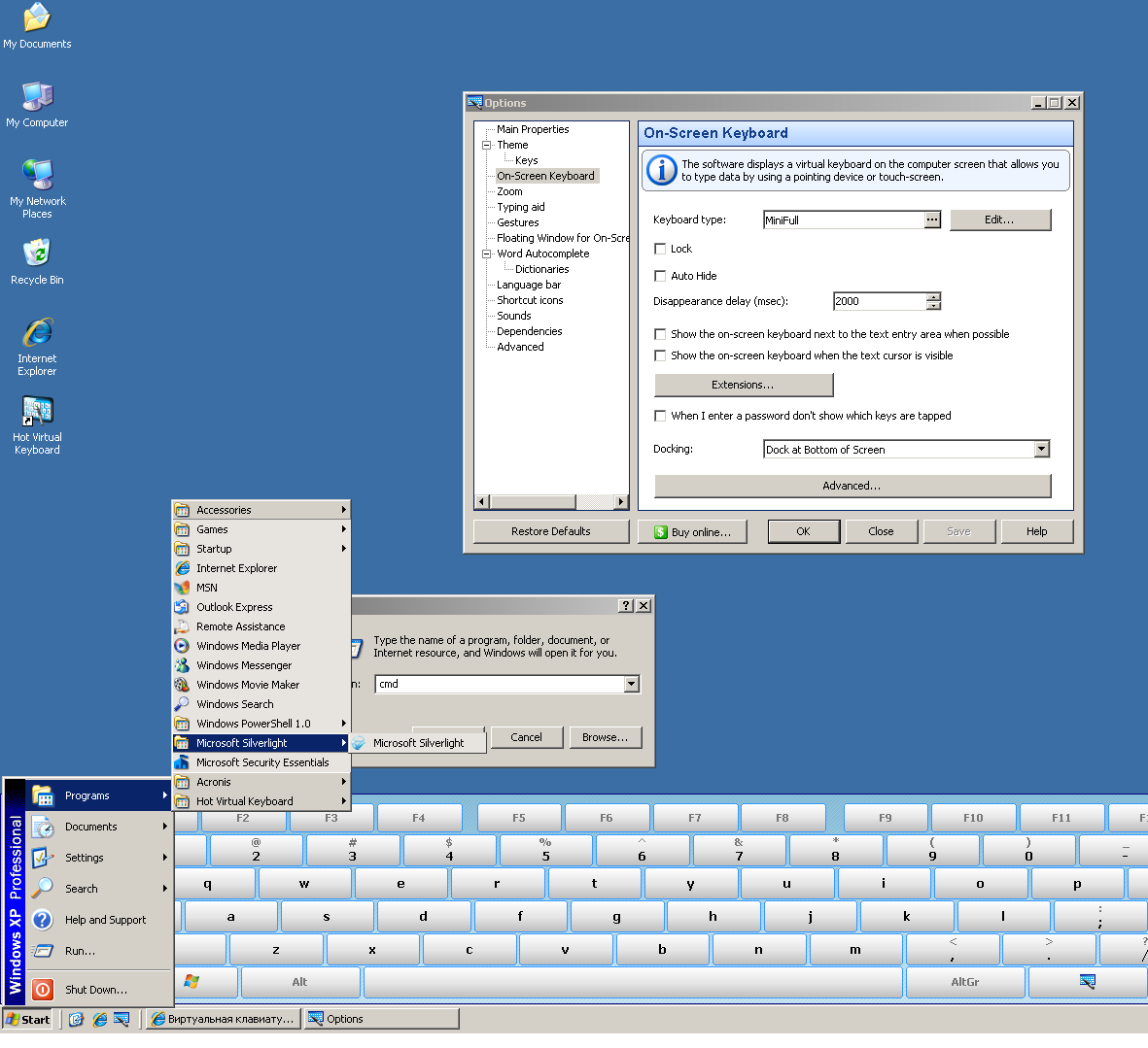

No, I'm asking if on Windows 7 or XP the standard start menu (its sub-menus, not the main menu) overlaps the keyboard. I know that it does overlap the taskbar.

PostPosted: Mon Jul 15, 2013 4:39 pm
Joined: Mon Jul 15, 2013 3:34 pm
Can you show a screenshot from Windows 7 or XP?
Here the screenshot of Windows XP. I mislead you a bit, Start Menu overlap Virtual Keyboard there (see Docking Option in Virtual Keyboard settings, that is non-default).
It was a bit unexpected, menu supposed to appead above virtual keyboard, but that's fine because Windows XP does not have Search option in menu,
while Run dialog appears straight above the keyboard, as expected.
