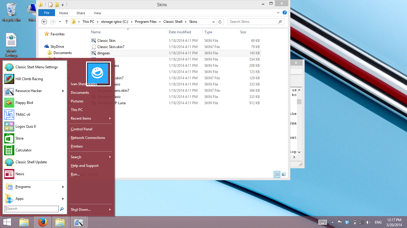

Ok, so I resaved the file under a different name and it worked, but now this happened:
Screenshot 2014-03-20 12.17.30.png [457.32 KiB]
Downloaded 1246 times
PostPosted: Thu Mar 20, 2014 9:42 am
You need to adjust the image offset and also the top padding of the second column (Main2_padding)
