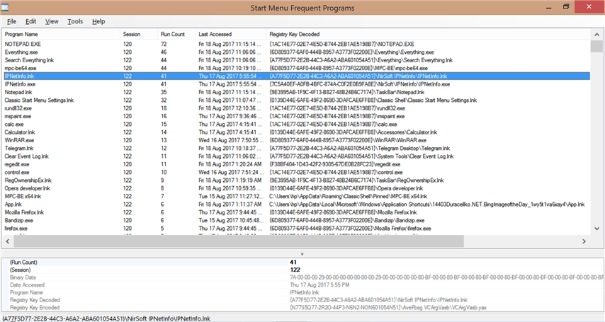

I use this app called Start Menu Frequent Programs (http://www.byounce.com/clicks/click.php?id=5). You can enter the UserAssist CLSIDs in it and then it decodes those Registry keys. The UserAssist CLSIDs for Windows 7/8.1 are:
{CEBFF5CD-ACE2-4F4F-9178-9926F41749EA},{F4E57C4B-2036-45F0-A9AB-443BCFE33D9F}
One is for LNK and other is for EXE files. Run it as administrator and enter these CLSIDs in Tools menu -> Options.
If I remember correctly, the Windows 7 UserAssist algorithm had some weird requirements: the program's shortcut must be in the Start Menu Programs folder, launched at least once using the shortcut for it to show up in the UserAssist Registry.
The Recent list will show it without issues because it is not based on data collected by Windows. It is maintained internally by Classic Shell. The Frequent list depends on what Windows collects and stores in the Registry. Classic Shell merely decodes it and "presents" it.

I downloaded Start Menu Frequent Programs; it shows pretty much the same thing as UserAssit program - i.e. 99% of all listed programs have a count=0. I have no idea how you managed a runCount of 72 for Notepad - I've used my Notepad just as much, but its count remains at 6 (my highest count). Windows seems to reset counts regularly. Your tool lets us change the run count however, so I increased IpNetInfo's two entries (LNK and EXE) from "2" to "99" -> It climbed near the top in Windows' own Start Menu; restarted Classic Start Menu -> Still not visible.
