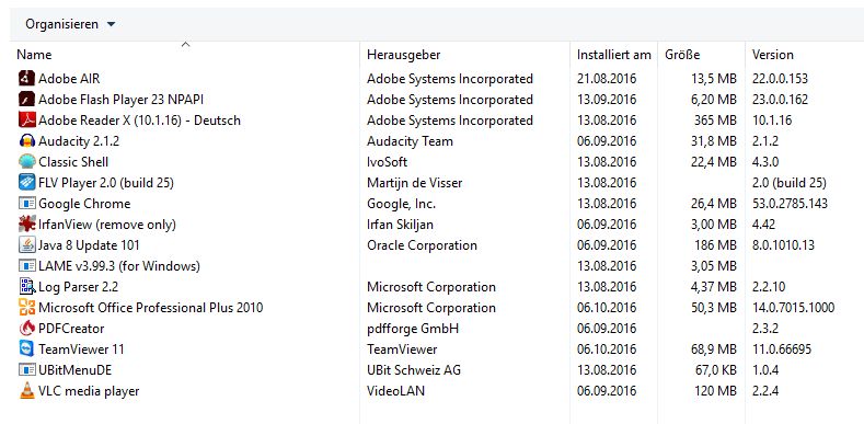

Hello,
I am responsible for two networks. They a very simular. In one network all PCs are runnig with Windows 10 and ClassicShell without any poblem. In the other network I can see exactly what is described here in this thread: The number of threads of the explorer increases untill round about 820 an than the explorer stops to react. If I kill the explorer and restart him later, everything works again fine until the next time.
The only big difference between the two networks is, that the one with the crashing explorer processes uses roaming profiles and the other not. Perhaps this information helps to find the problem. For testing purposes I installed a fresh virtual PC with only standard software. But also here the problem occurs.
PS: I love ClassicShell and I don't know, how I could Windows 10 use anymore without it - many thanks!
File comment: Software which is installed on my virtual Test-PC
