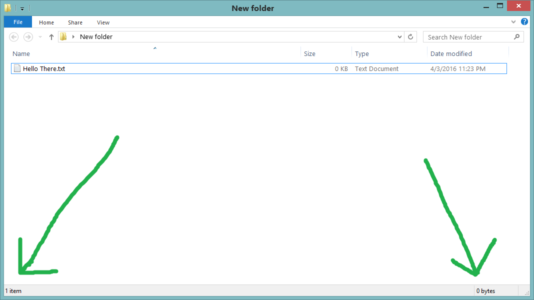

Hello,
If this has been discussed before, I apologize for not being able to find the thread for it. But I attached a picture of what I'm talking about. Is it possible to increase the font size of where it says how many items are in a folder & the size of the total files there. I drew green arrows that point at them.
Thanks

PostPosted: Sun Apr 03, 2016 11:53 pm
If you increase your Windows system DPI (set DPI scaling to a higher value), the font size of the text in the status bar is scaled. However I think in the future, Ivo may have to increase the height of the status bar, so the large font fits inside it.

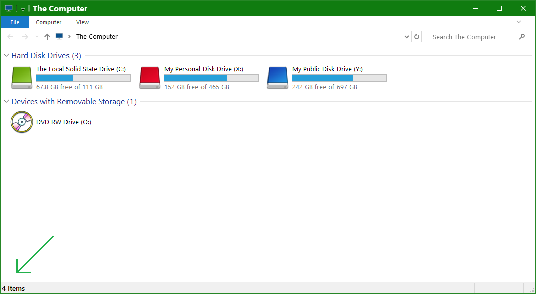

Hi, I just want to post back on here to state that this has been fixed. There is a feature within Classic Explorer now that allows the modification of the Status Bar font & size.

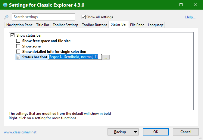

Hello, yes I'll show you what to do.
First thing though, I'm running Classic Explorer 4.3.0. Check to see if you have those options in your version before getting this new version. If your version has this setting then you're good.
Open Classic Explorer settings and refer to the picture I attached. Press the button with the three dots. I set mine as:
Font: Segoe UI
Font Style: Semibold
Hope this helped =)

PostPosted: Mon Aug 14, 2017 10:56 pm
Have you checked "Show all settings" at the top?

PostPosted: Tue Aug 15, 2017 6:37 am
Joined: Thu Sep 01, 2016 4:04 pm
Posts: 6
Actually I had already checked it, otherwise the status bar options tab wouldn't have appeared at all. Only three options show up on that tab, and I have enabled all three, which are working:
"Show free space and file size"
"Show detailed info for single selection"
"Force status refresh"
By the way, everything else in Classic Shell is super! I especially like your replacement for the file conflict dialogue; the native dialogue in Windows 7 is so wordy that part of it drops below my screen and I can't hit the confirmation button.
Gerry
PostPosted: Tue Aug 15, 2017 6:57 am
Oh, right, you are using Windows 7. This setting is not available on Windows 7, because in this case the status bar comes from Explorer.
On Windows 8 and up, Classic Shell creates its own status bar and can use whatever font it wants. But on Windows 7 the font is decided by Explorer.
