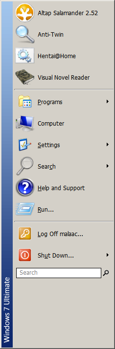

Latest version in Windows 7 x64 does not properly resize. When I clear recent apps there is a huge gap that shows up at the bottom and until I click off and click back on the menu looks all messed up due to the huge gap.

Which menu style are you using/ If you are using the Windows 7 style, there is a "Minimum menu height" setting on the Main Menu tab. You can reduce it so even with less or no recent apps, the menu will be shorter. Note that if you reduce the minimum height, you naturally see less search results too.
If this is not what you mean by "huge gap at the bottom", please show a screenshot.

Ok I had 3 items in recent items. I did a right click > clear recent items. As you can see the entire menu moves up and the bottom gets a big gap. This use to not happen it use to clear recent and show the proper start menu size. The gap is bigger depending on how many recent items I clear.. the entire menu shifts up instead of resizes.
PostPosted: Mon Sep 21, 2015 11:29 pm
Yes I could reproduce the problem with the Classic single column style if using the "Recent" list and the list is cleared. Thanks for reporting the bug.

Ok glad you could I just finally got a chance to upload the file you asked for but you already was able to reproduce.
PostPosted: Sat Nov 14, 2015 11:38 am
This is fixed in the latest version 4.2.5.
