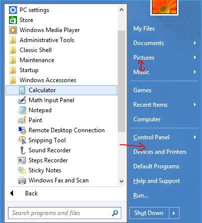

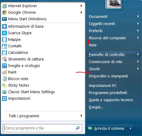

Hello Everyone,
i searched for a long time on the forum and on the application settings but i only could find "font size" and not exactly what i'm searching.
My goal is to increase the space between the voices in the menù (screenshot 1 is my menù). As you can see, they are compact there with little space between each other (sorry for the ugly arrows)
In screenshot 2 is how the screenshot program and how in one of my other real windows 7 machine looks: there is much more space between the menues.
Can anybody help me to find the function that increases the space?
thank you very much and i apologize in case i could not find an already posted topic with the same question
Gianluca

PostPosted: Thu Aug 13, 2015 8:31 am
Looks like in Screenshot 1 you have set the "Small icons" skin setting, which also reduces the padding in the right column. If you don't want to turn this off and still have more padding, you will have to edit the skin: http://www.classicshell.net/tutorials/skintutorial.html
Look for a setting called Main2_text_padding.

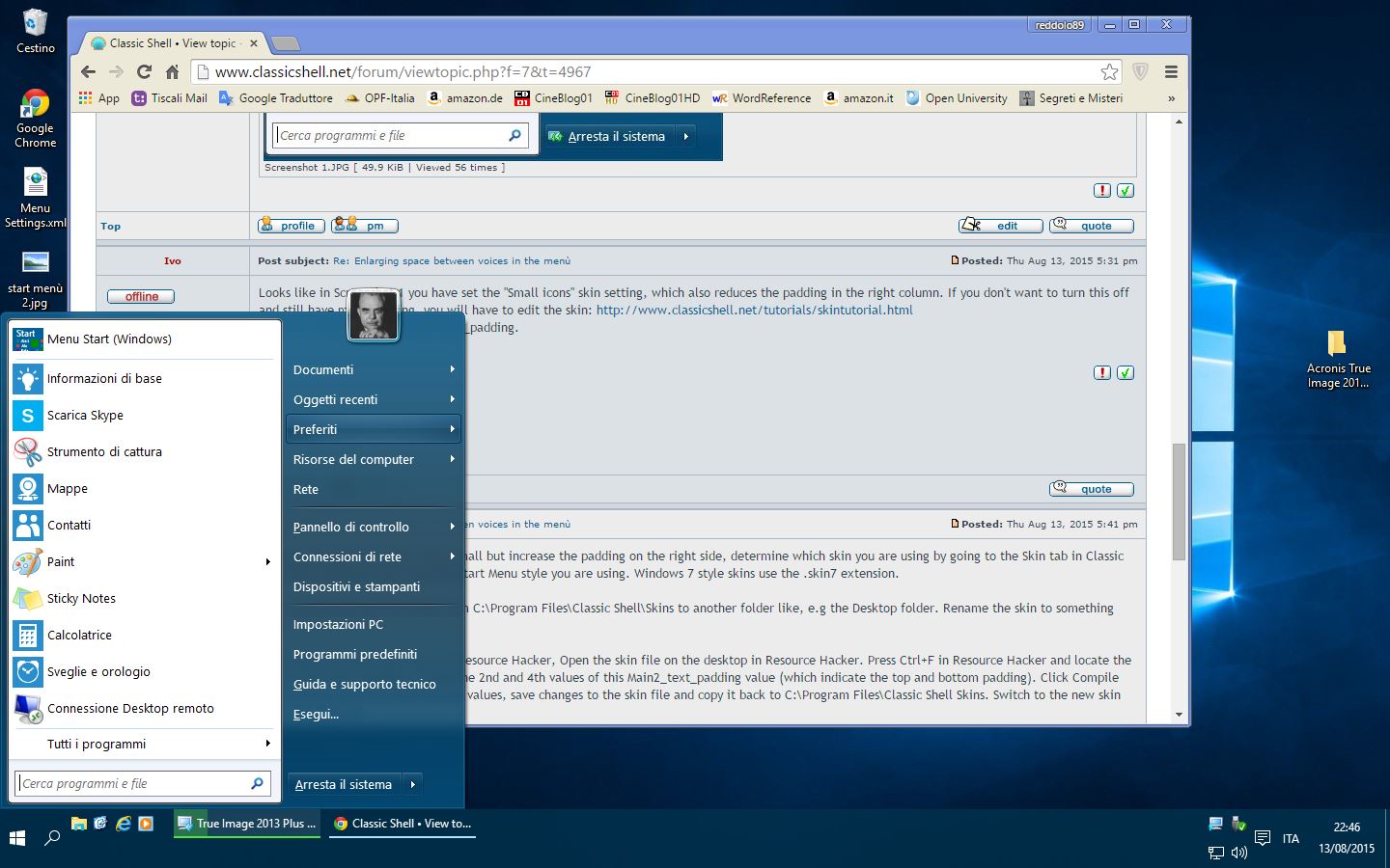

Hello you both,
i deeply thank you for your answer to my post!
I tried to use large icons and also large font. The result is in screenshot 3. It definitely looks bigger, but still not as much space as the screenshot 2, also because i would really like if possible to keep the icons small (but still big spaces).
To answer to GauravK: thank you for giving me another option. The first one you wrote sounded really complicate :)
I'm using Windows 7 style on Windows Aero Them. On a windows 10 OS, if this might help.
Any idea if i'm the only one with this issue or i'm being too picky?
Thank you so much for your help in this!
Screenshot 3.JPG [187.04 KiB]
