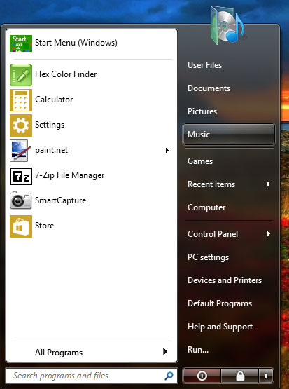

VISTALIKE
I don't know if you are still around OneSerendipity?
I have uploaded our team skin. I tweaked to max thru the midnight hours. =_=
Come hither to the dither noise.
I finished the version of the Vista look-a-like skin. Anyone can use parts of it for their own purposes.
It has modified parts from you both, and of what I had given already, and some new ones too.
I got bugged out looking at all the horizontal banding stripes on the menu.
(low bit image makes transition lines, because there are only 256 steps of brightness)
So I spent time adding dithering to the main menu. It really did a nice job. Thanks old Adobe elements 5.
Bitmap had to be made wider to get full benefit. The 2nd column looks a lot smoother. Unfortunately, the lightness changed.
It still looks half ok resembling Vista, with the black at bottom. The glaring original bright menu top is more subtle.
I put the skin in the "Vista Icon" zip folder. Just take it out of there, and put in CSM skins folder.
If you want to have the Vista icons show on this menu, or your own, put that Vista icon folder in drive C.
Load the Vistalike.xml file into CSM to set it to use those icons. :)
This folder did not compress well (2.36 MB). If you just want the smaller skin zip (419 KB), uploaded as well.
I was using your nice light powder buttons for awhile, until I used the real Vista.
I figured I better try and use as much original, to please Splitwirez.
Difficult to find buttons in the system, or when I found them, the brightness/alpha does not look the same,
so I made some from screen shots, and others made by hand, from scratch.

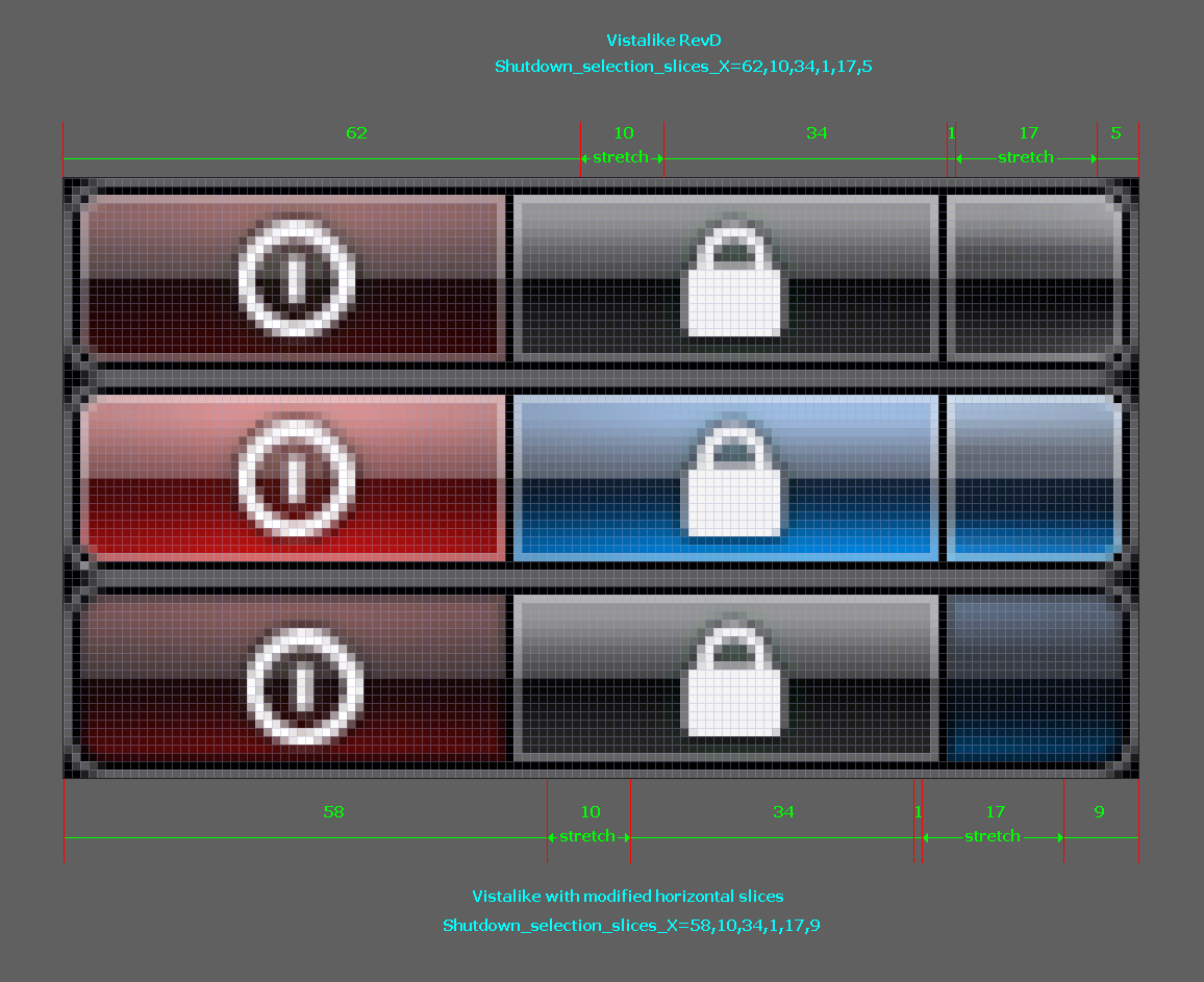

The skin can also be used for 150% size. This and the search box padding took the longest to get right.
The last search padding hurdle, was because the top background search padding number was too low.
I kept increasing it until it joins/overlaps with the main menu .
I settled on 99 value, no reason. That overlap is just barely visible on the little white border line.
Unless you really look for it, it hides.
As the power button has to use exact dimensions, I only put the regular size, and 150% size in skin.
For any other dot per inch settings in between 100% & 150%,
I set it so they don't try and grow bigger, and screw up the fake icon look. Now I know why Ivo says that sizing % can be set for different parameters in script.
Could not figure why menu goes out of alignment. Had to set some values to 0%, and others to 100%. Could not figure out how to freeze the size of power button, when it has text on it. The fake icon goes wonky, if anything other than 100%/150% size. :(

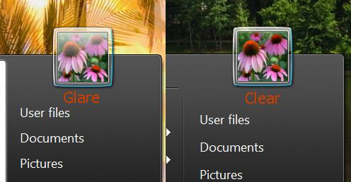

Ooh, I think I know what was going on with the downloaded user picture frame turning grey at top half. If the square part for picture is totally black alpha, the user picture will be same original brightness. If there is some alpha layer value in that square, that will make what ever rgb value visible.
With Vista, MS made it have some fuzzy glare. So it shows some white haze on top of user picture. From the modded bitmap, someone darkened the rgb value, which made grey show.
If you want to reduce the glare more, have to darken the alpha layer, and keep the original white rgb layer.
I modded that downloaded bitmap of yours, or some bodies. I darkened the alpha layer a bit .
Hope you learn from using parts of this, or just use the skin on it's own.
Never figured out Ivo's "font none" thing. Text still showed.
If you use this skin in Windows 10, set the glass opacity to 0 in the "Menu Look" tab of CSM.
Bye :)
PS
If I'm rattling on a bit too much, I consumed a little yeast ethanol, to get the creative juices flowing. :)

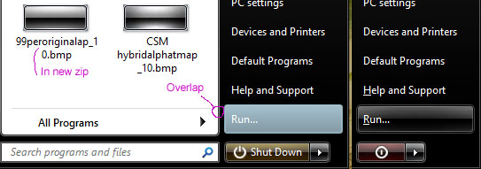

Ah, frizelnits.
I forgot to put in the latest glass buttons for 2nd pane.
I'm not sure if it makes that much difference in the menu.
It looks totally different as a Windows .bmp thumbnail,
as only the rgb channels show, not the alpha/rgb blend like a .png file.
Just swap them out, no text change required.

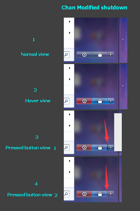

In picture are the other two shutdown button styles available in the skin already. :)
Bitmap 10 and 16.zip [8.77 KiB]
Downloaded 7845 times

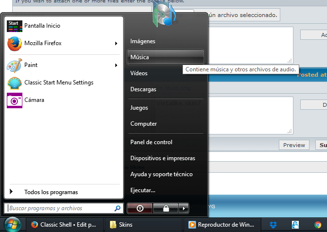

I'm using windows 8, but I miss windows vista styles.
I test windows 10, but I don't liked it and I was return to 8.
so
this is a screenshot of
my
start menu. Thank's.

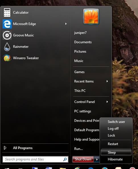

PostPosted: Fri Feb 26, 2016 3:53 pm
Good, that it's working, Zoek

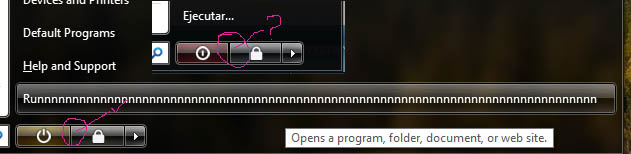

I'm just not happy that the divider in the power button looks different, in your screenshot.
I never tried it in other languages, where the names are longer.
Well, we all tried to get it right. It isn't perfect.
You can always use OneSerendipity original skin at the beginning of post.
That skin uses a different method to set the size of the power button.
PostPosted: Fri Feb 26, 2016 4:14 pm

I can't duplicate what you have in screen shot.
I made second column the widest and still looks ok.
OK. Now I'm laughing to myself.
I think it is just the way your screenshot was captured and magnified.
I don't think there is a problem.
Never mind what I was saying.

What was only the second column glass, is now everywhere, including submenu.
I took the VistaLike skin that we made, and converted to Full Glass VistaLike. For CSM 4.3.0
It kind of looks like a 7 style version of the Classic "Smoked Glass" skin, when set on weak color.
Only this skin is darker at the bottom part.
Adding mild color basically starts to look like a lot of other full glass skins.
I like it best when set on black color & weak setting, with or without transparency blur.
That's where the skin shines,,, no,,smokes. :D
Due to the special shutdown button, it's only proper size at 96 reg/144 HiDPI.
If you want shutdown with proper size at 120 DPI, switch to the "Standard text only"
Note about Vista look shutdown button, and language.
Was made for English language. Other languages will move the fake padlock icon off center.
Looks different on Win7 OS(a lot less color)
There are still some horizontal ripple lines in the menu.
I would need better image editor, capable of better dither.
EDIT: Added option to use invisible font, just for the shutdown button, to better cover up the dark pixels that show up sometimes.
Full Glass Vistalike RevB.zip [491.63 KiB]
Downloaded 8180 times

PostPosted: Sun Feb 11, 2018 3:04 pm
My first attempt at the Vista user picture frame was not good.
Now,
I found the correct one (with more transparency), in the Vista Windows files, but it was kind of jagged.
I also found a smoothed out one by thoriumknight at Devient:
https://thoriumknight.deviantart.com/ar ... -150733456
I combined them to make one for HiDPI.
I also put an option to show no glare clear picture inside. :)

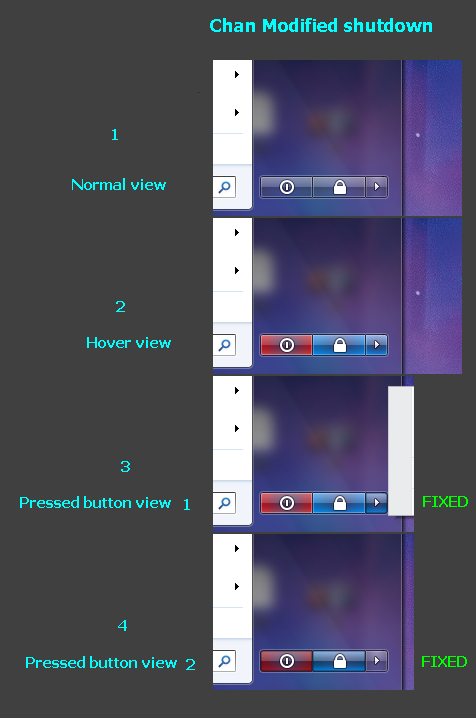

I got an email from Chan and wants help figuring out what's wrong with his modification shutdown button:
Hi juniper, I have a Classic Shell theme question that want to ask you.
I made a Windows 7 Beta Power Button based on your VISTALIKE PowerButton Fix RevD.
There is no problem with the appearance of this Button or when the mouse is moved over the Button (picture1, 2), but when the mouse is pressed on the button, there is something wrong between the middle and right buttons. Press it. Blue shadow effect, too short or too long (picture3, 4)
I've been looking for this problem for a long time, but I can't find where the problem is...
Could you help me?
Thank you.
I just used the following code from VISTALIKE PowerButton Fix RevD
[BETA_POWER_BUTTON AND WHITE_SPLIT]
Shutdown_selection=400
Shutdown_search_selection=400
Shutdown_jump_selection=400
Shutdown_selection_slices_X=58,10,34,1,17,9
Shutdown_selection_slices_Y=5,14,5
Shutdown_icon_padding=5,3,-21,3,100%
Shutdown_text_color=#000000,#000000
Shutdown_search_text_color=#000000,#000000
Shutdown_jump_text_color=#000000,#000000
Shutdown_arrow=257
Shutdown_search_arrow=257
Shutdown_jump_arrow=257
Shutdown_arrow_padding=11,9,100%
Shutdown_font="Segoe UI",normal,1
Shutdown_text_padding=119,0,-21,21,0%
Shutdown_padding=0,9,0,8,100%
Shutdown_selection_mask=0
Shutdown_search_selection_mask=0
Shutdown_jump_selection_mask=0
Hi Chan.
I’m guessing that either your modified shutdown bitmap has different horizontal dimensions,
or each (normal, hover, pressed) image is not lined up exactly,
or the horizontal slices are stretching a part of bitmap that should not be (at dividing part of buttons).
Look at the compare picture to see the difference.
So, as the start menu shrinks or expands horizontally, the extra vertical line may disappear or turn into a wider vertical line.
I could be totally wrong. :roll:
I did not look at all the padding amounts.
Hoping all you need to do is change the X slices back to original.
I have no idea why you would get different colors when pressing the shutdown menu button.
Good luck and bye. :)
PostPosted: Fri Jul 26, 2024 3:36 pm
Continuation of email
Hi juniper.
I have modified the values of Shutdown_selection_slices_X and
Shutdown_arrow_padding.
Because after I enlarged the picture, I found that the length of the
middle lock button is 4 pixels shorter than the original picture.
When I tried to modify Shutdown_selection_slices_X, I found that the arrow
button on the right was deformed, and then I modified
modified :
original :
Shutdown_selection_slices_X=62,10,34,1,17,5
Shutdown_arrow_padding=7,9,100%
I'll try to figure out how slices work haha
If want to extend the length of the middle lock button by 4 pixels and the
effect can be displayed normally, is this possible?
Thank you juniper :)
What's a bit confusing is that the total length of the image is 129
pixels.
If use your original 62,10,34,1,17,5 = 62+10+34+1+17+5 = 129
But the total length of the final displayed effect is 126 pixels,I don't
know why the middle lock button is 3 pixels missing ...
P.S :
It should be 3 pixels missing, not 4 pixels mentioned in the previous
email :)
Hi Chan.
Someone could make a button 2,000 pixels wide, but the software will
shrink it down to fit in the start menu.
If software shrunk all the stretchable pixel slices,
it will then cut into the non stretching pixel slices making distortion
like you got with the arrow.
I have not experimented for a long time.
I will let you do the experiments. :)
See if this does anything?
Change the 10 pixels to 6 and add 4 extra pixels to 62 to become 66 pixels.
Does it do anything?
If not, the only thing is increase Shutdown_text_padding
Bye
Hi juniper there's good news
Just tried your suggestion, changed the pixels to 66 and 6, but the total length has not changed and is the same as before, 126
Then I tried to increase Shutdown_text_padding, and the middle lock button finally changed haha Now the total length is normal :)
This problem has been bothering me for almost a day, thank you for your help and finally solved it :D
