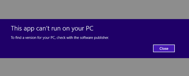

Upgraded to 8.1 and then I did the repair of 3.6.8 and managed to get the shell back; however, i still get the error message on 8.1 when i try to open 4.0.2 that "this app can't run on your PC" ... am i missing something? Thanx.
PostPosted: Wed Oct 30, 2013 1:13 am
From my own experience, this particular unhelpful error shows up usually in 2 cases: #1 when the program files for an application are corrupted or #2 when running a program with the wrong processor architecture. #2 is ruled out in this case. So try to uninstall Classic Shell completely from Programs and Features Control Panel and reinstall. All your settings will be preserved.

Please understand, v 3.6.8 of ClassicShell is running fine, no corruption that I can see. It's when i try to open the new version install program that the error occurs, i never get to install it.

Have you tried downloading it again? Maybe the full file didn't get downloaded? Also, SmartScreen may be blocking the installer. Try disabling SmartScreen from the Action Center.

redownloaded and disabled smart screen. that seems to have done the trick. thanx!
