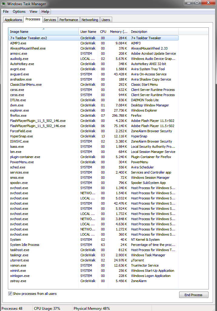

PostPosted: Wed Jan 30, 2013 12:20 am
Joined: Tue Jan 29, 2013 11:14 pm
Posts: 6
This is an capture of my task manager.
Maybe it helps.

PostPosted: Wed Jan 30, 2013 12:42 am
The only software I see that may be related to the problem is the 7 Taskbar Tweaker. Few people have reported incompatibility in the past. I've been using it myself for years without problems though.
Just as a test, disable it (uncheck "Run at startup" in the 7TT settings) and log off. See if that fixes things.
PostPosted: Wed Jan 30, 2013 1:21 am
I've also been using 7+TT without issue. Zone Alarm also often causes a lot of incompatibilities and problems with MANY programs from my personal experience. I would recommend uninstalling ZA temporarily to see if it works with ZA installed.
PostPosted: Wed Jan 30, 2013 2:26 am
Posts: 6
I stopped 7 taskbar tweaker.
Still doesn't work....
You might be right with ZA though... the problems started because of ZA.
Can you recomend another firewall instead of ZA?
Thank you.
PostPosted: Wed Jan 30, 2013 2:40 am
Modern versions of Windows don't need a third party firewall. The built-in one is excellent, although it doesn't block outbound programs by default. You can install a free program like Windows7FirewallControl by Sphinx Software to block outbound connections in Windows Firewall and get a notification when something is blocked. Of course, this 3rd party recommendation is only for your convenience. Use at your own risk. Unsupported by Classic Shell.
PostPosted: Wed Jan 30, 2013 2:53 am
Posts: 6
I have uninstalled ZoneAlarm and now classicshell works.
Thank you for your time and suggestions.
I wish you all the best.
