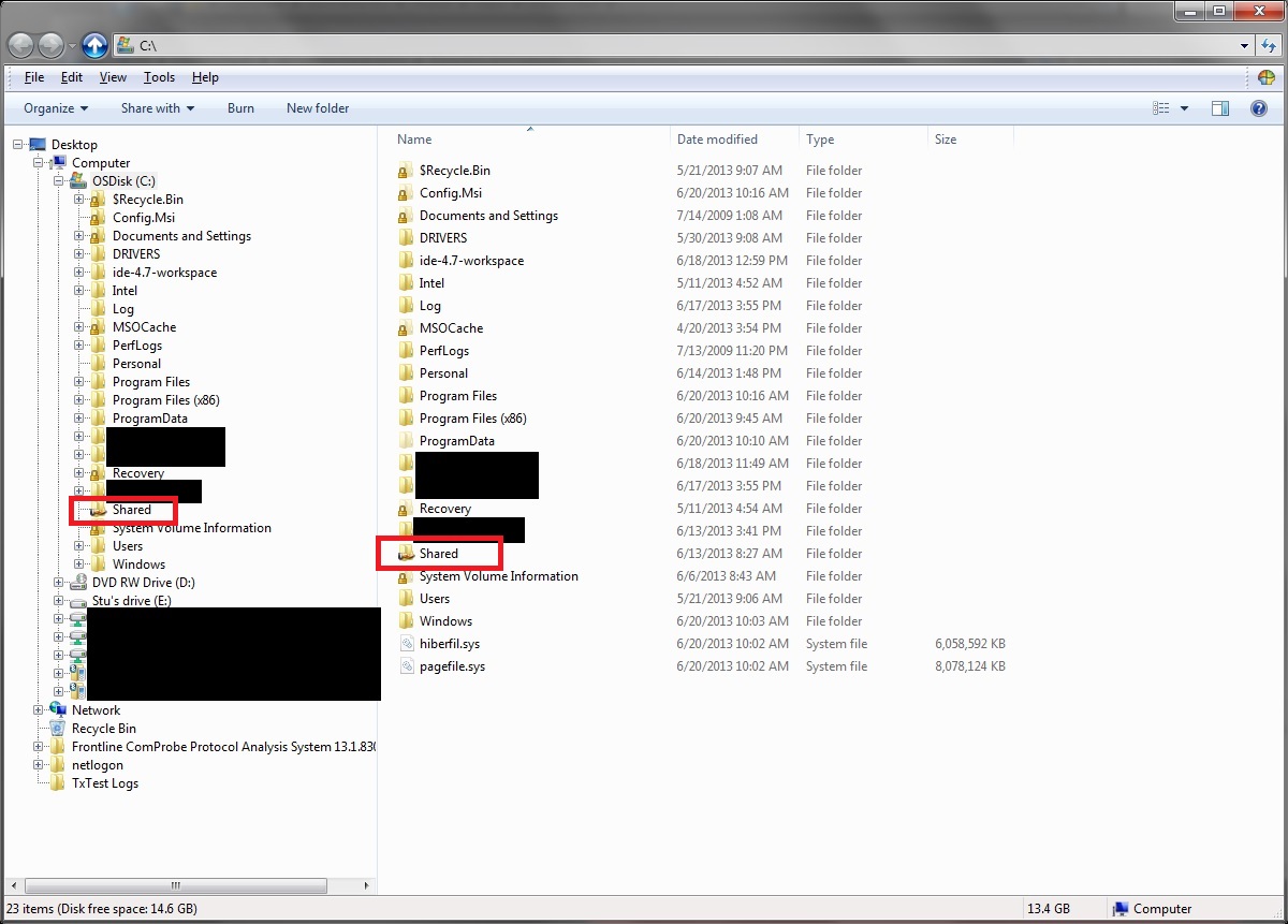

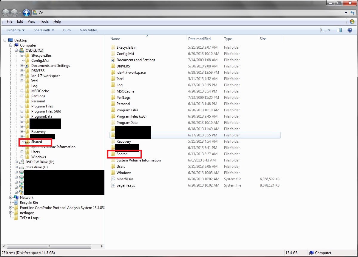

Okay, the screenshots should be attached to this post; one showing normal operation and one showing the bug.
It appears to be a conflict between ClassicShell and TortoiseSVN in certain configurations.

File comment: Shared overlay
File comment: No shared overlay

I updated the screenshots to highlight the exact problem I am seeing.
File comment: Shared overlay; marked
File comment: No shared overlay; marked
PostPosted: Thu Jun 20, 2013 8:18 am
It looks like you have hit the limit for the maximum number of shell overlay icons Explorer can have. It has a limit of 15 overlay icons.
You can see all the installed overlays at this registry key:
HKLM\SOFTWARE\Microsoft\Windows\CurrentVersion\Explorer\ShellIconOverlayIdentifiers
If they're 14 or 15 it means you've hit the limit due to other software also installed which shows overlays.
