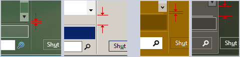

Is there a "programs background padding text" that can be put in skin script?
I've noticed the starting point for internal programs pane/box can vary from skin to skin.
It's a puzzle for me to figure out what changes it from small gap to larger gap.
Does not seem to matter if search box is built in, or a search bitmap is used.
A skin I'm working on started out with a narrow gap, now it has a larger gap.
I just want it locked down to one height, so it does not fluctuate any more. :)

The size of the programs tree is rounded to fit an exact number if items. Depending on the height of the entire menu, there may or may not be a gap at the bottom. That's how it works in the Windows 7 menu as well.
