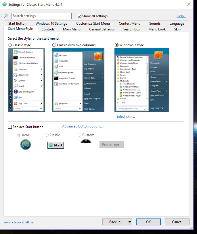

PostPosted: Wed Oct 14, 2015 8:20 pm
Are you saying when you right click the start button and choose settings, this page doesnt pop up?
You might not have classic shells menu installed..?
PostPosted: Wed Oct 14, 2015 8:33 pm
Minimum menu height is a Setting, not a button. Go to the Start Menu style tab and switch to "Windows 7 style". Then that setting will be available from Main Menu tab.
