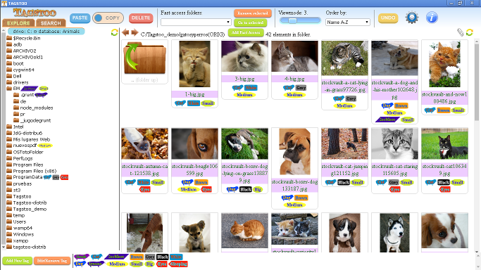

If someone is searching for tagging software, I recently develop (because the previously tested software does´not fulfil my expectations of a visual and easy interface among others) a free and open source application capable of tag folders and files with tags of different shapes (and colors of course), construct specific search like all “white” “small” “dogs” and “brown” “big” “cats” and show all them in search results, multimedia files preview both in explorer and search, also epub previews, integrated image visualizer, various view modes; like a list or cards of different sizes, etc..
You can check it in:
https://tagstoo.sourceforge.io/
and compare with previously existing software:
http://tabbles.net/
https://www.tagspaces.org/
http://lunarfrog.com/projects/taggedfrog
(I don´t like comparisons and in some ways those programs can be more advanced, the programmers can know much more than me, like in Tabbles that have some kind of integration with windows, but for me are incommodious in their usage, and as mentioned don't fulfil my requirements, that is why created Tagstoo).
