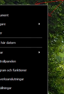

I want a complete black menu, so i have set it to solid color black, but i can't get rid of the white border around it.
How do i get rid of that white thin frame around the menu?
(the red arrows points to them as shown in the screenshot.)
I don't understand which code that is i have to change to get it total black without frames?
I'm using Resource hacker.
Help appreciated!

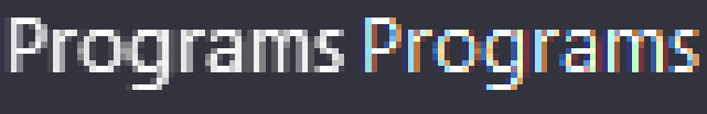

Hi Corso.
I don't have time to help you, but I found a fuzzy look on some skins if opacity is not alpha.
See picture. Is this the kind of blurry?
The left was either full glass, or region. The right was alpha.

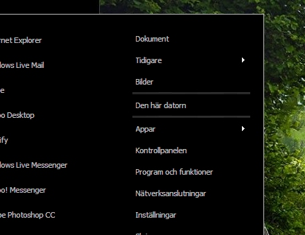

I've tried them all opcacity fullglass, glass, alpha etc..
but still the menutext looks weak, kinda fragile. Hard to explain.
When i put the cursor over the menutext the text gets "filled in" and looks right.
But when closing the menu and reopen it it looks the same again. It's weird.
I've attached a screenshot.

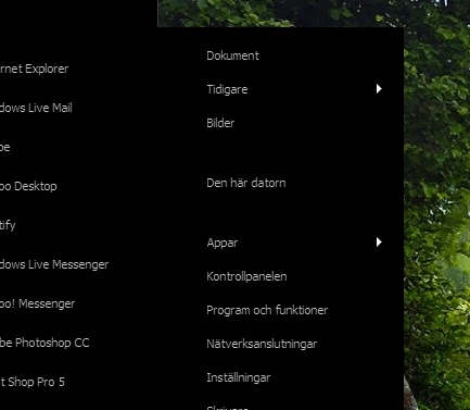

The skin is Metro Glass. I've set the opacity to solid, when in solid the menutext is correct! See attached pic.
But then i get that annoying White frame around the menu. When setting the opacity to glass or fullglass or alpha, then the text gets thin and all that i explained.
In the screenshot the text and menu is right, except that White frame around it i don't wanna have.
So i don't understand why it gets like that. I just can't figure that out.
