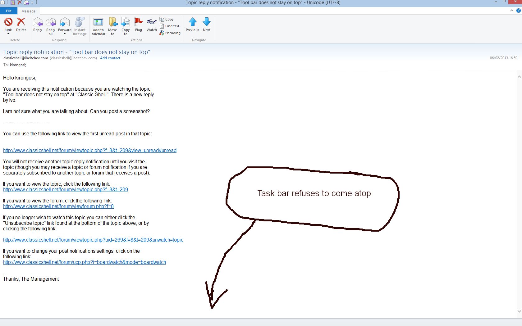

:cry: The task bar of my CLASSIC EXPLORER, when I use WINDOWS LIVE MAIL maximized, does not stay on top; either, when I attempt to reduce the window to médium size, it does not obey. So, to click a button on the task bar I need to minimize the whole window:cry:

Here they are
Clipboard02.jpg [162.79 KiB]
Downloaded 23575 times
Clipboard01.jpg [48.97 KiB]
PostPosted: Wed Feb 06, 2013 1:51 pm
OK, The taskbar is not part of Classic Explorer. Classic Explorer adds a toolbar to the Windows Explorer windows.
Do you have your taskbar set to auto-hide? Does it hide when you maximize another application, like Explorer?

Remarks: my OS is Widows8; I have installed Classic Shell on W8; W8 has no taskbar; the taskbar appeared on the desktop provided by Classic Shell, so, I believe, it must do part of it; to me Classic Explorer and Classic Shell are the same thing; taskbar is set to auto hide; it hides when I maximize InternetExplorer and unhide afterwards when I pass the mouse on the botton border; when I open LiveMail it opens in médium size and the taskbar is hidden; while the LiveMail is in médium size, the taskbar hides and unhides; when I maximize LiveMail, the taskbar refuses to unhide

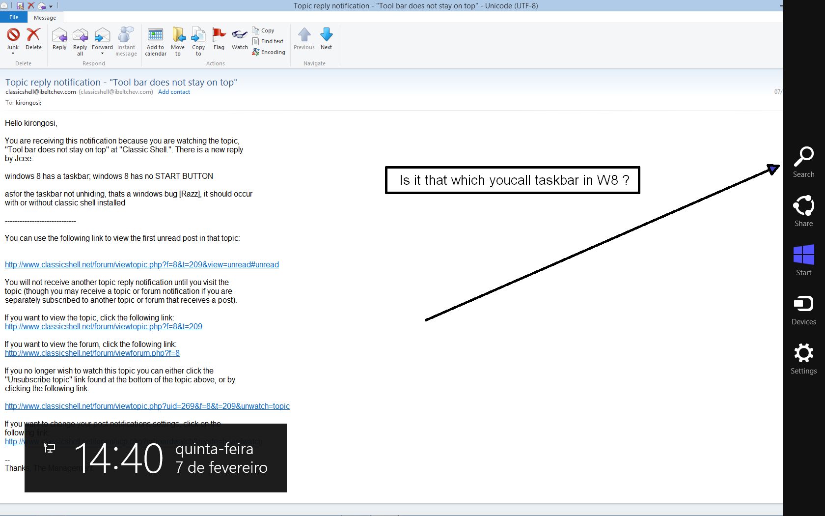

Is it that which you call taskbar in W8 ?
Clipboard01.jpg [172.07 KiB]
Downloaded 23561 times
PostPosted: Thu Feb 07, 2013 10:11 am
No, that's the charms bar. The taskbar is the thing at the bottom that has a button for each running program. That's where the Classic Shell's start button goes. It's been there since Windows 95.

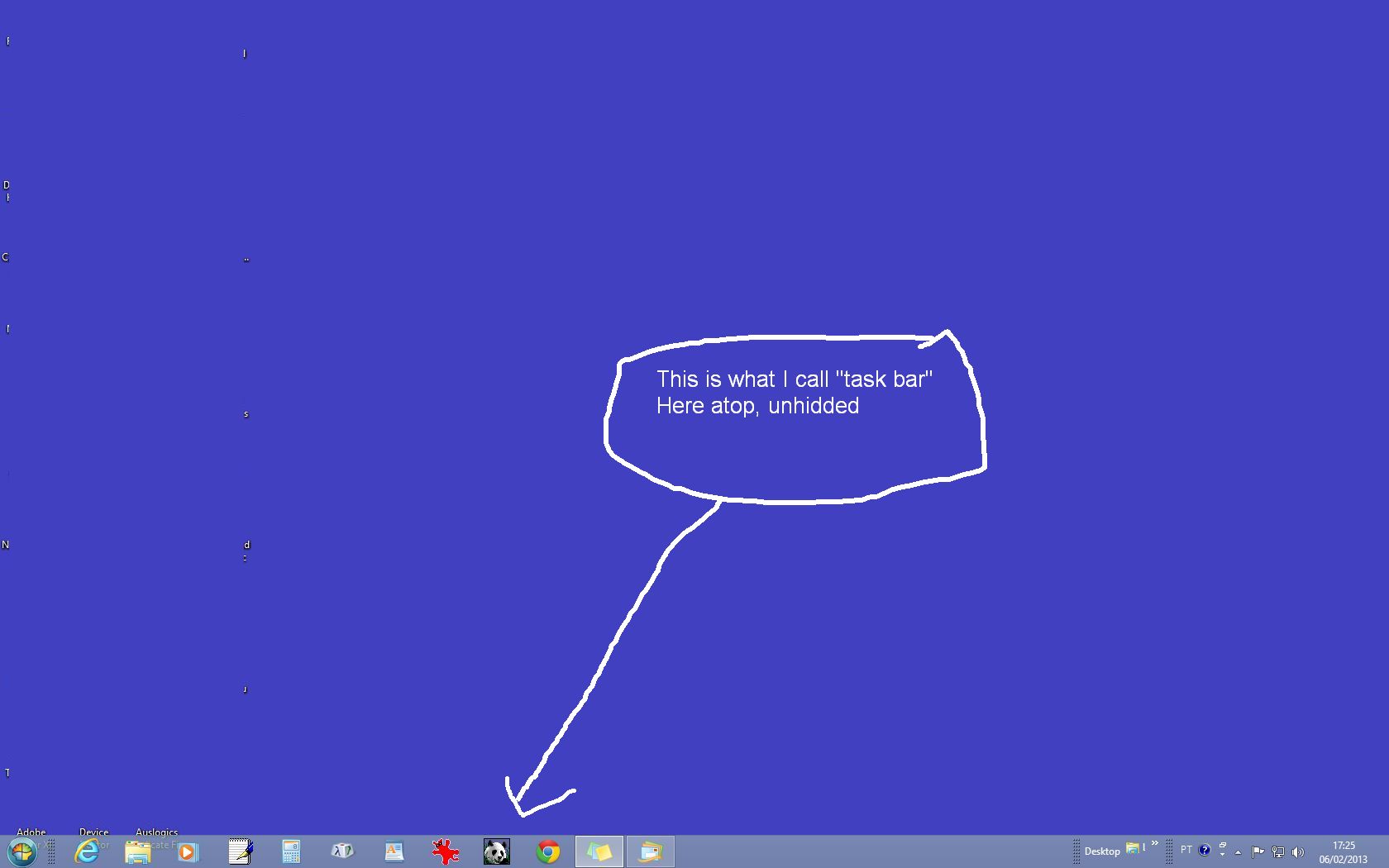

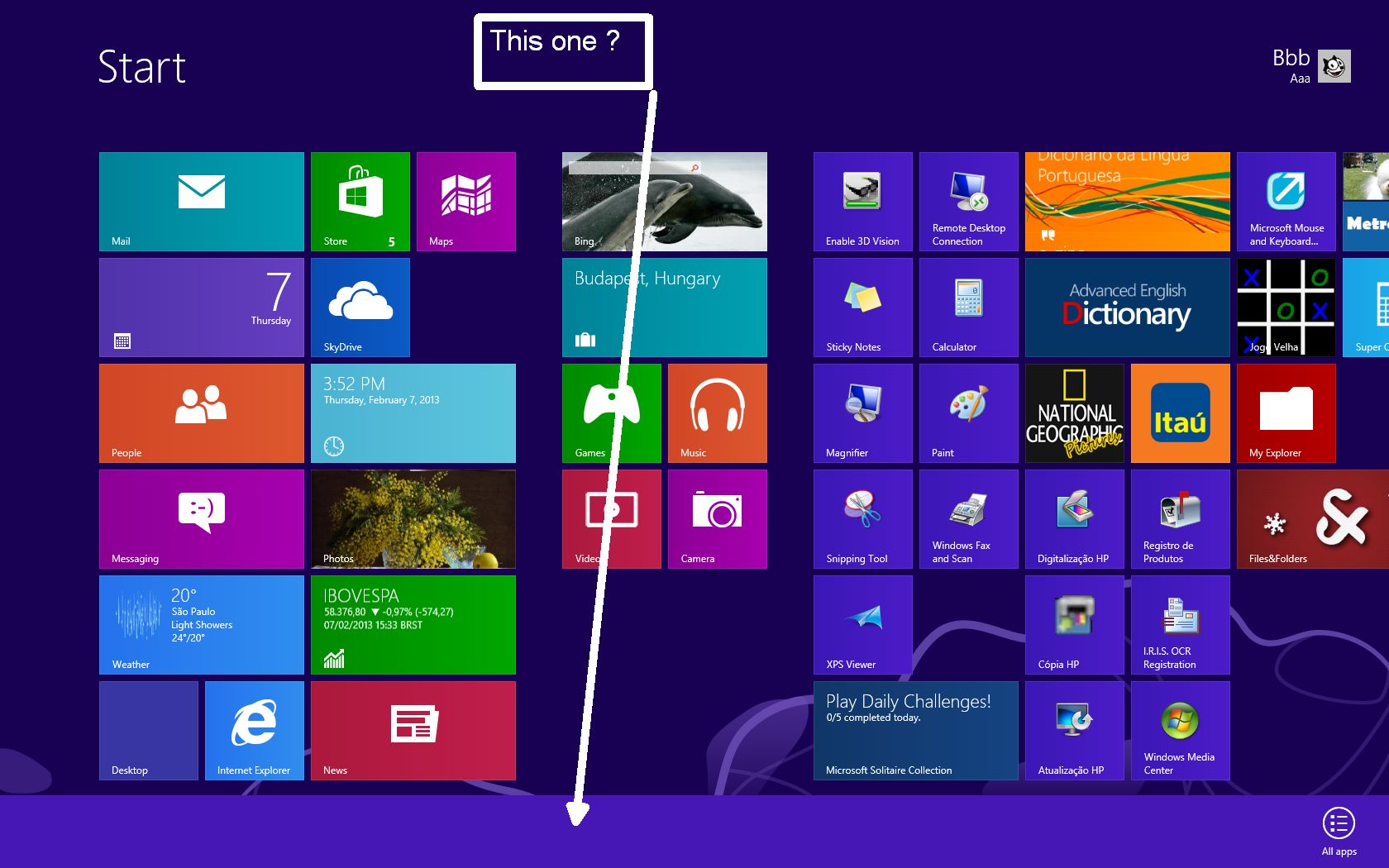

I am a cliente since MSDOS 1.0. Would be the one shown below ?
Clipboard02.jpg [165.19 KiB]
Downloaded 23559 times
PostPosted: Thu Feb 07, 2013 11:34 am
No, it is the one you have in your second picture - This is what I call "task bar"
