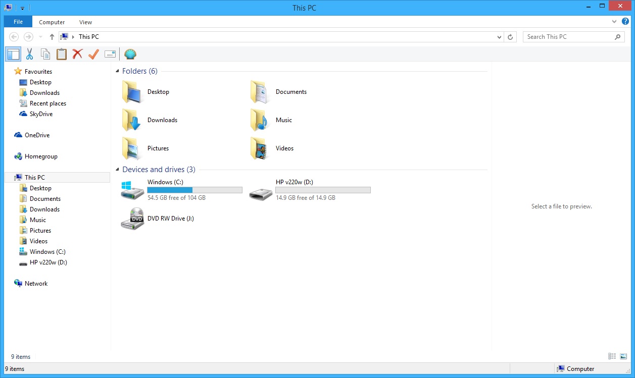

I am having an issue with the 'Menu Bar' not showing, when I say Menu Bar I mean the thing which says : File, Edit, View, Tools, Etc
I've attached a picture below :
Now I believe I first had this when I installed Classic Shell, but I no longer seem to have it?
I have attached a Screenshot of my Explorer - as you can see I get all the icons, which I can change, but I don't get the Menu Bar.

In Windows 8, the menu bar has been removed and replaced by the Ribbon UI except for a few folders like Control Panel. To disable the Ribbon UI and get back the menu bar, you can use OldNewExplorer: http://www.msfn.org/board/topic/170375-oldnewexplorer-make-your-81-explorer-work-like-win78-one/

That looks like a different menu to what I want though?
I would like the following circled bit :
Rather than the bit below, like this :
Is it still what I want?
Many Thanks

OldNewExplorer has a setting to disable the Ribbon as shown in this article: http://winaero.com/blog/oldnewexplorer- ... artisback/ The setting is called "Use command bar instead of Ribbon". With that turned on, the Ribbon gets disabled and the menu bar and command bar return as they were in Windows 7.
