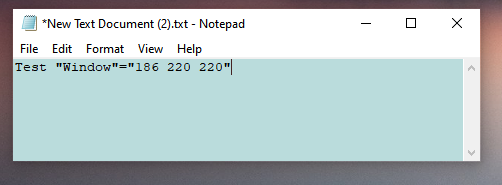

I did a test by changing the "Window" red green blue value to "Window"="186 220 220"
at two places in the Modified Windows colors.reg file (right-click edit).
Saved it with the changes, then right-click merged into the registry, and restarted Windows 10.
If it was Windows XP the explorer window would change color, not on Windows 10.
What it did was change the window color on Notepad and inside part of the search box of older programs.
Maybe there is a program that can make these system color changes easily without messing with the registry?
Modified and reset Window colors .zip [1.31 KiB]
Downloaded 3684 times
