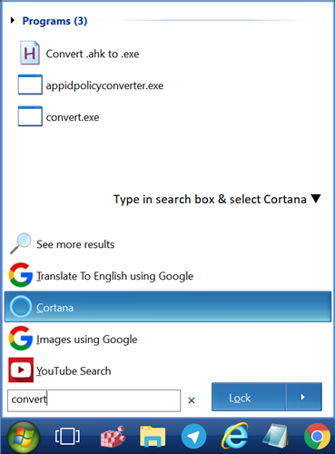

PostPosted: Sun Jun 11, 2017 1:56 am
A screenshot of this in action:
