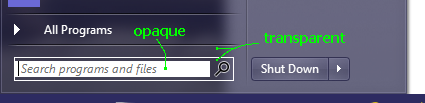

PostPosted: Mon Dec 17, 2018 4:42 pm
Meh i know the overall background can be transparent. the search specifically I dont recall. you've got more skins under your belt than me; so most likely not possible :P. I was just commenting that even if it was possible, anything with detail makes it really hard to read text on a transparent background. unless you can add the blur. and even then its hard to account for the background color (if you got black text, and a black background you cant read it. same with white.
PostPosted: Mon Dec 17, 2018 6:10 pm
Yes, It would look terrible if it was transparent to behind the start menu.
It only needs to be transparent to show the start menu behind it, like how a selector button normally works.
I'm sure it can be done. We just don't have all the info to do it, and time is running out.
Take a look at the purple menu picture of a modded Smoked Glass 7 style skin. It uses a real search image.
I intentionally made the Search_background image fully transparent on the outside (was already), and inside of the white frame.
I could have erased the frame as well but kept to show that the inside of search box can be transparent,
except for the narrow white bar area, which I think is some kind of internal opaque mask in the program.
If we could figure how to get rid of that, then at least it would work on a 7 style menu.
There has to be some keyword to use in a skin file to disable that opaque mask. :)

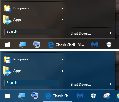

PostPosted: Sat Jan 05, 2019 11:02 pm
Classic Shell is still up. Time for one more simple skin.
Here is another one of those classic 1/2 style menus with a darker search box option.
No round menu corners, just square.
Mostly flat, less saturated dark glass colour or very dark without colour menu.
Can switch between blur and old transparency.
I don't recall seeing the millisecond glass color flash when opening parts of menu from like a year ago.
It must have something to do with using newer Windows 10 upgrade versions.
They are always messing up something as they shift forward.
Example: The jump lists stop working on the Classic Shell menu. I found out Win 10 update turned off Jump lists. :twisted:
Anyway, back to the original subject.
Back in the start menu skins pages, there are a few more similar dark search box skins somewhere.
Even Dr. mykou was experimenting with black search box Classic Shell menus for DeviantArt and Youtube in the past.
At some point in time, I will ask over on GitHub if they can add skin text for a transparent search box,
and a way to colour the internal search frame.
EDIT:
Just now I put in a request on GitHub Open-Shell
Will see if anything happens.
My name over there is "CTVCAM8"
https://github.com/Open-Shell/Open-Shel ... issues/129

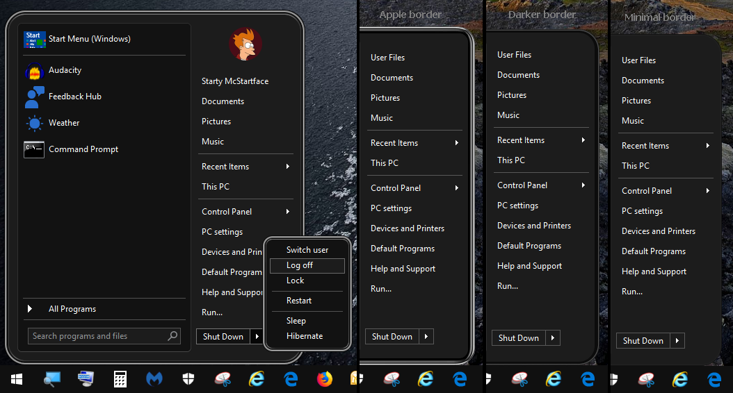

PostPosted: Sun Jan 13, 2019 12:10 pm
Another one for the road.
It's just a dark opaque 7 style skin.7
Even though I never figured out a transparent search box,
what bugs me more is the search box flashes for a brief instant.
What I now see happens, is part of the inside of dark-colored search box will show the desktop behind the menu,
( like when using a 24-bit selector bitmap instead of 32-bit on a transparent menu).
Problem is, it's an opaque menu with alpha opacity.
I can duplicate effect almost every time by hovering over submenu entries, then click on the search box.
If I switch to region opacity the flashing goes away, but due to the round menu corners,
extra artifacts there don't look so hot, so it has to be alpha opacity on this menu.
I might bring it up on GitHub, but I see there are only about 4 persons over there who help out when they have time,
and it's not exactly crippling menu operation.
Edit: Added opaque glass color for Windows 10. Now revision H
It does look a bit goofy. :lol:
Win7,8 will desaturate/wash out the color. Boost it in Color & Appearance settings,
or can improve slightly by adjusting CSM settings in "Menu Look" tab with:
Menu glass intensity: 50
Menu color blending:0
