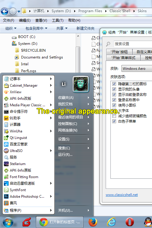

I would like to use Classic Start Menu with "Two-column classic style" on Win7, but I don't like the user icon position with this style, I like to set the icon to the center as "Windows 7 style".
Can Classic Start Menu change user icon position? I cannot find such option in Classic Start Menu's setting page.

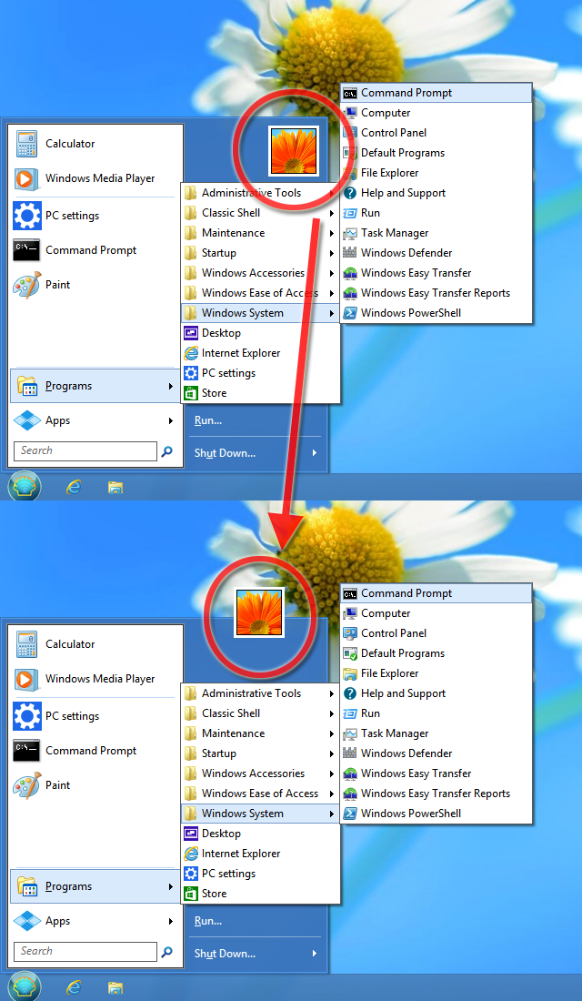

PostPosted: Fri Aug 14, 2015 8:40 pm
You can center the image horizontally, but you can't make it appear outside of the menu. You will need to edit the skin: http://www.classicshell.net/tutorials/skintutorial.html
Look for the setting User_frame_position and set it to:
User_frame_position=center2,6

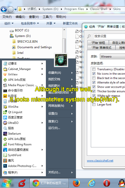

PostPosted: Fri Aug 14, 2015 10:51 pm
Give this skin (attached to this post) a try. Download it to Desktop and then copy it to C:\Program Files\Classic Shell\Skins. Then switch to it from the Skins tab.
Also, go to the Menu Look tab in Classic Start Menu settings and uncheck the setting "Enable menu shadow". Then this skin will look correct.
Winaero.skin [321.5 KiB]
Downloaded 1023 times

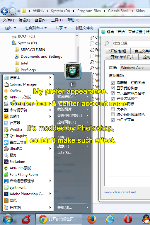

Thanks,your skin runs well, but I feel it mismatches win7 aero style.
Could Classic Start Menu add such style skin in next version?
