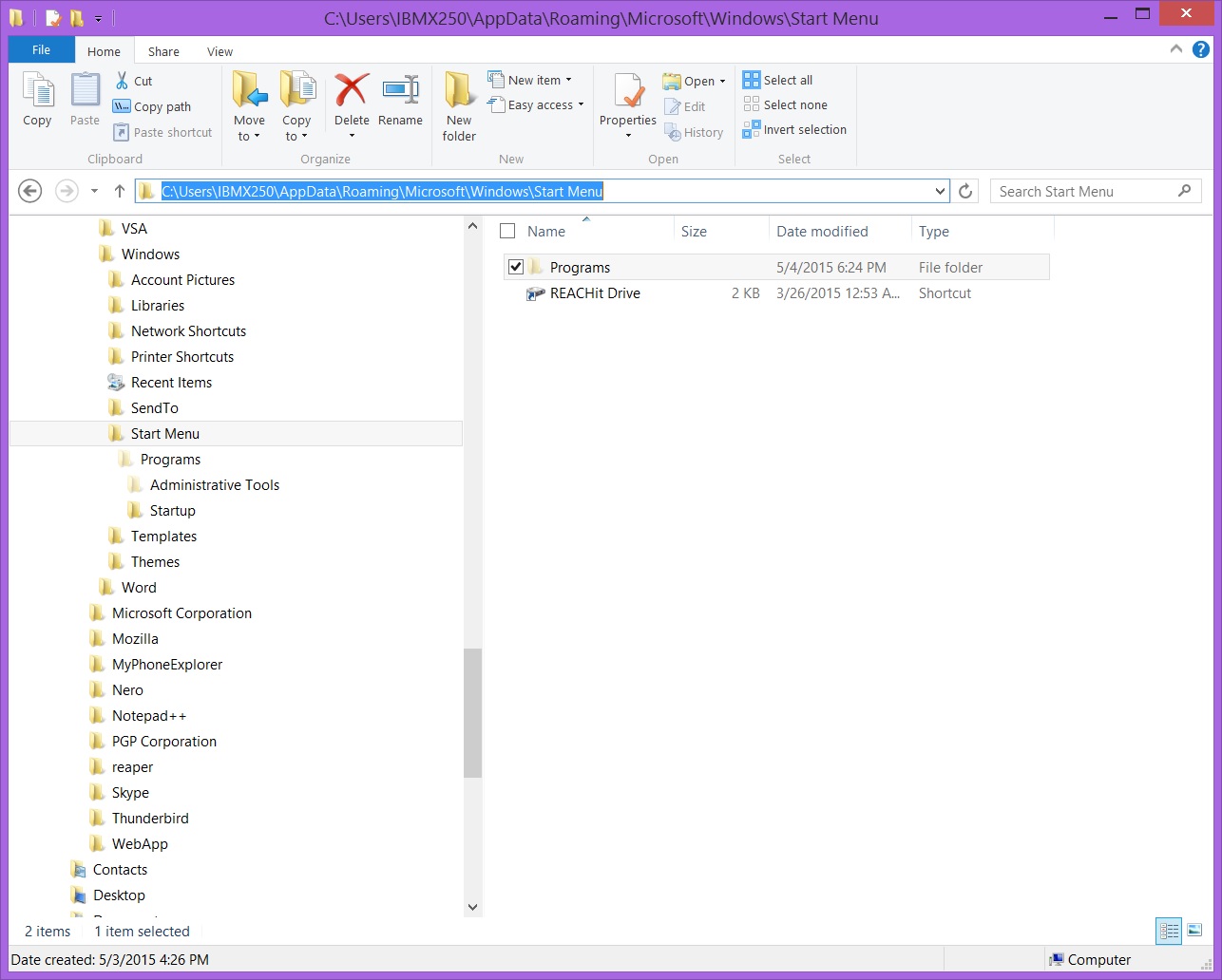

Hello,
You would think that would be the problem, but it doesn't seem to be. There is only one programs folder inside the user menu folder structure, and likewise for the all user menu structure. See the attached graphics for confirmation.
Any other ideas?

Folder redirection was not used, but looking into it has given me a clue, though not a solution yet.
When I noticed that there was a Programs folder inside a Programs folder, I deleted what I thought was the extra copy of the Programs folder, and recreated any shortcuts and folders inside that, which is why my Start menu looks fairly clean. However, part of the reason it looks clean is that I hid the Programs folder in the User menu.
Anyway, I note that currently, my user Start menu folder does have a location tab, but the Programs folder inside it does NOT. (Checking another machine, it DOES.) So, apparently, I deleted the system folder and replaced it with and ordinary one with no Location tab. So, how do I reestablish the system aspect of the user Programs folder and get the location tab back on it?
-still stymied
