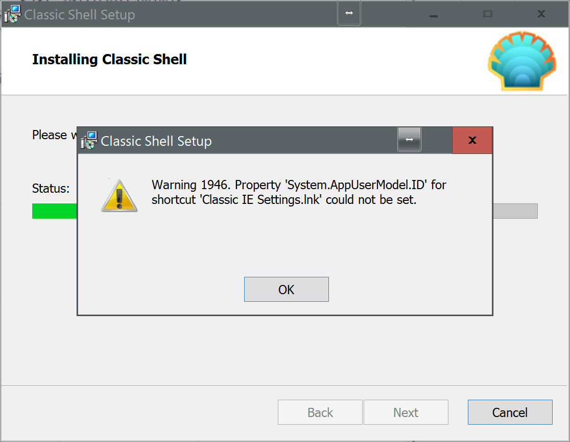

PostPosted: Thu Jul 13, 2017 11:27 am
Joined: Thu Jul 13, 2017 11:19 am
My new laptop came with Windows 10 Pro and I believe it is the Anniversary version.
I installed Classic Shell menu for the first time today but got an error message during install.
The programs seems to be working anyway so should I be concerned about this error?
PostPosted: Thu Jul 13, 2017 2:23 pm
I think you can disregard that. Was the installer running in some compatibility mode?
PostPosted: Fri Jul 14, 2017 2:34 am
No it wasn't although I did run it in admin mode.
My guess is it came up due to Edge being on my machine rather than IE.

Okay, seeing as it started to happen after nearly every damn login, I started to troubleshoot.
It is definitely caused by Classic Explorer.
I uninstalled and reinstalled the program after I randomly got this message after the issue happened today:
I tried installing only classic explorer; issue appears. Installed only classic start menu; no issue.
So it appears classic explorer isn't fully compatible with W10 CU, if not W10 itself. Maybe it's an option I'm using, I don't know, I have so many customized settings and trying to troubleshoot them is an ordeal. The most I can try is exporting my settings, resetting to default and seeing if it still happens.

@DAOWAce, what version of Classic Shell did you have installed? Version 4.3.1 should be compatible with Creators Update.
PostPosted: Sat Sep 30, 2017 8:00 pm
Joined: Tue Aug 01, 2017 1:55 pm
@Gaurav: That message came up with version 4.3.1 installed. It appeared after I had one of my explorer hangs on login which I manually recovered from (ctrl+alt+del, task manager, restart explorer.exe) instead of letting time out.
I updated to it from 4.3.0 after I posted on August 31st. I upgraded to Windows 10 with 4.0.1 installed which I upgraded to 4.3.0 right after. (just mentioning it for chain of events for possible troubleshooting)
There are clearly some compatibility issues/bugs left, as evident by my issue and a couple other people reporting more.
