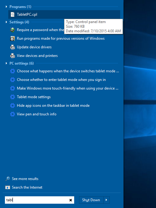

PostPosted: Tue Aug 11, 2015 3:43 am
The Start Menu already searches the PC Settings.

PostPosted: Tue Aug 11, 2015 4:56 am
Right click start button>Classic Shell Settings
Type 'pc' into the search box
the only setting available should be the one you need
(alternatively its in the "Search Box" tab, when show all settings is checked)
PostPosted: Tue Aug 11, 2015 4:58 am
If PC Settings are not being searched for you at all, try this:
1. In Classic Start Menu settings, go to the "Search box" tab. Make sure the "Search PC settings" option is checked.
2. In Control Panel -> Indexing Options -> Advanced -> go to the file type, settingcontent-ms. Try changing the default from "Index properties and file contents" to "Index properties only".
The index will be rebuilt. That will take time depending on how many files and folders you have added to the index. After it is rebuilt, you should be able to search PC Settings too.
