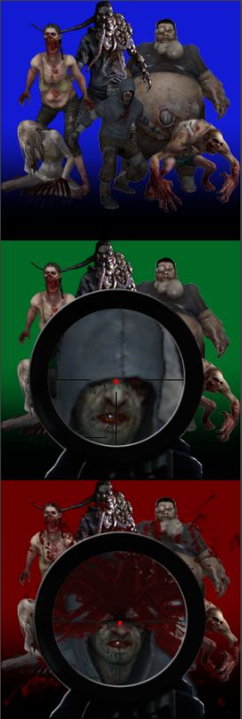

its also a good idea to set up a Color Square Checking System, as such:
___________________
  • If your image is 300x300, for example, create a new layer, select it, and fill it with Red
  • Resize your image Canvas to 300wx900h
  • Duplicate the Red Color layer 2 times
  • Use the Fill Bucket to fill one Square with Blue and one square with Green
  • Set the three color boxes exactly on the document so they are not overlapping, and there is no space between them, and they are centered exactly in the middle.. so one nudge of any block in any direction will leave a blank space.
  • Set the 3 color block layers behind all other layers
  • Normal State:
    • Set you first Image of the Normal State on the top, centered on the top colored block
    • Click the layer for the color block thats on top
    • Ctrl+Click the Layer to select the block, or Use a Magic Wand select it
    • Right-Click and select "Invert" to select the space of the bottom two squares
    • Click your top graphic image layer, and hit Delete on your keyboard
  • Hot State:
    • Set you first Image of the Hot State in the Middle section, centered on the middle colored block
    • Click the layer for the color block thats in the middle
    • Right-Click and select "Invert" to select the space of the squares above & below it
    • Click your middle graphic image layer, and hit Delete on your keyboard
  • Click State:
    • Set you first Image of the Click State on the bottom, centered on the bottom colored block
    • Click the layer for the color block thats on bottom
    • Right-Click and select "Invert" to select the space of the two squares above it
  • Hide the 3 color Block Layers
  • You should now have a very clean graphic with no overlapping or strange alignment
  • Save as PNG with Transparency
  • Done

Below is an Example, the Original Can be found Here:
