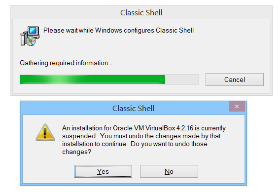

PostPosted: Mon Jul 08, 2013 4:30 am
Posts: 71
I just tried to uninstalled the previous beta version in order to install the new beta. Uninstalling produced the attached screenshot below. I clicked on 'No' and Vbox was uninstalled. CSM still remained so I uninstalled it again and all went OK. Why do I have problems with Vbox? Seems CSM and Vbox on my system have some sort of deadly embrace.
PostPosted: Mon Jul 08, 2013 8:10 am
That's quite weird. It is possible both softwares share a GUID somewhere but the odds for that are very slim. It is more likely that the Windows Installer got its wires crossed somewhere.
PostPosted: Mon Jul 08, 2013 9:15 am
Posts: 71
I recall that when I installed the latest version of Vbox it hung up on me so I canceled it after about 10 minutes. However it did work. IMO it's the Ethernet connection it sets up to allow communication between the host and guest that is causing the problem.
I since uninstalled Vbox and maybe I'll try VMware in the future.
PostPosted: Mon Jul 08, 2013 9:39 am
I have seen such a message with Windows Installer when an installation of product X didn't complete and product Y's installation was started. So I guess there is no conflict as such.
