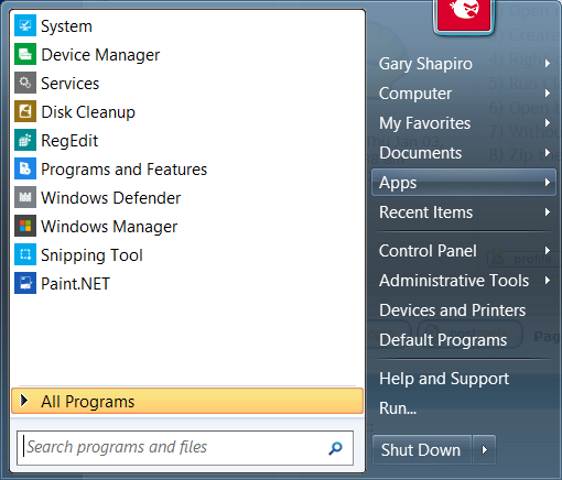

I have the Apps entry in column two and it is always highlighted as if I was hovering over it.
PostPosted: Mon Jun 17, 2013 7:47 am
It's highlighted to notify you of newly installed Apps that you may not have launched yet. The feature is optional of course, so you can turn off the highlighting from the General Behavior tab (Uncheck "Highlight newly installed programs").

OK, here's what I need you to do:
1) First take a screenshot of the main menu, and when the Apps menu is open. Post them here.

PostPosted: Mon Jun 17, 2013 8:39 am
Posts: 71
Here's the files:

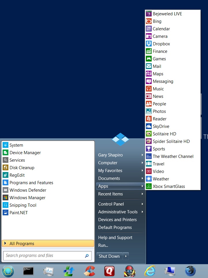

That's very weird. There should be a lot more data in the log file. Delete it and then make sure it is created again.
I'd like to see a screenshot with the Apps menu open as well.
PostPosted: Mon Jun 17, 2013 9:12 am
Posts: 71
Log file is the same as before.
PostPosted: Mon Jun 17, 2013 9:32 am
I think the two issues are connected. The log file is most likely empty for the same reason the Apps is highlighted.
I will need to add some more logging to get to the bottom of this.
BTW, just to make sure - you do have the "Highlight newly installed programs" checked, right? Does unchecking it have any effect?

Unchecking "Highlight newly installed programs" is what's causing the highlight to stay. I don't want to highlight new programs and I don't want the App entry to always be highlighted.
