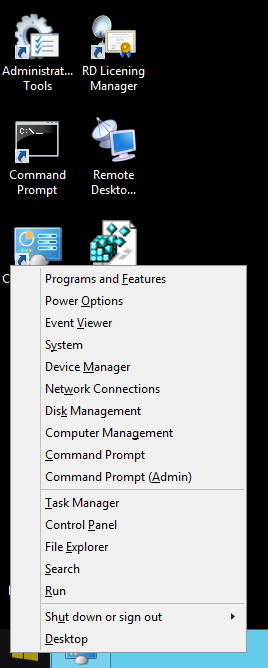

I am trying to disable right context menu bar on Windows Server 2012 R2 Standard 64 bit.
Is there way to do from classics Shell?

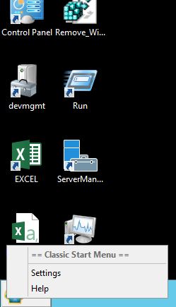

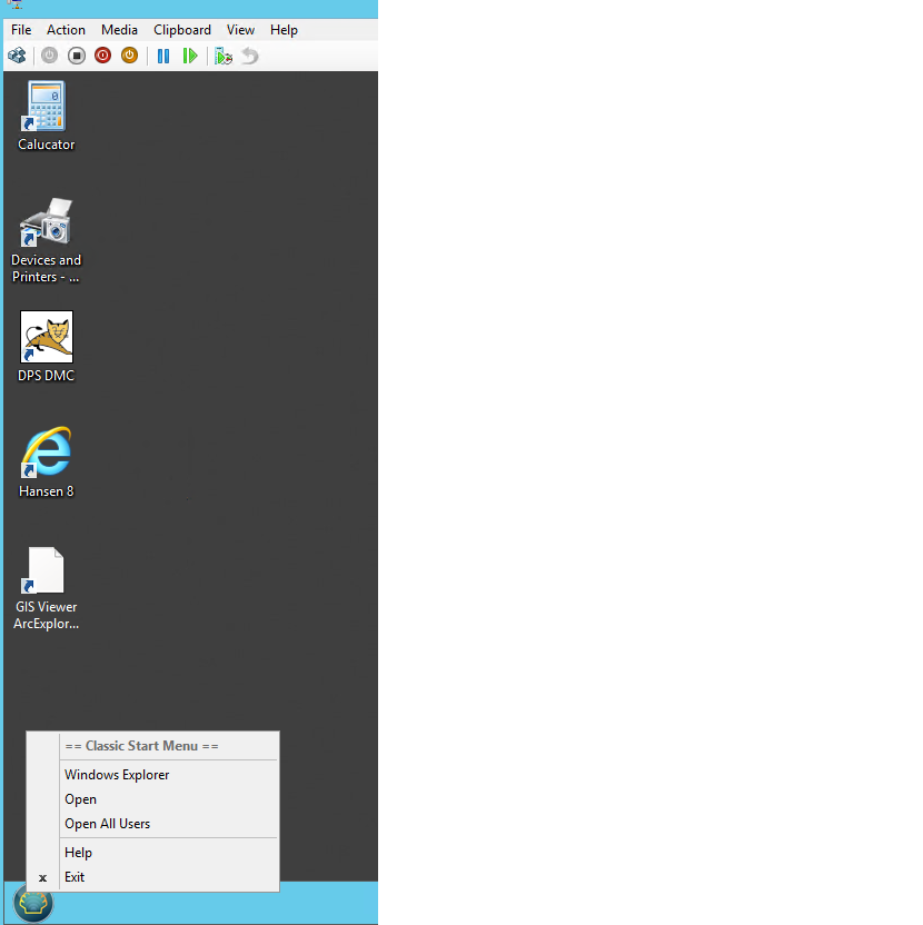

I am really appreciate for your response. I am able to disable right context but there are still some menu shows from classic menu. I need to complete disable that menu too. Can you please suggest/help? I have attached snap shot of classic context right click menu .

Here is another one right click context menu from Classic shell.

PostPosted: Thu Jun 09, 2016 10:48 am
Rename or delete the help file at C:\Program Files\Classic Shell\ClassicShell.chm.
There is a Registry DWORD value supported in HKLM\Software\IvoSoft\ClassicStartMenu called "EnableSettings". Set it to 0 to fully disable the Settings dialog.

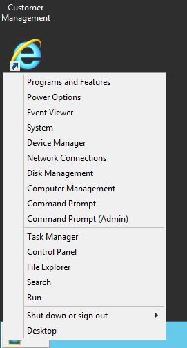

I did setup 0 for "EnableSetting" from the HKEY_LOCAL_MACHINE. but still showing context right menu.
PostPosted: Fri Jun 10, 2016 9:39 pm
This menu is not part of Classic Shell.
This is the Win+X context menu added in Windows 8/Server 2012. It cannot be disabled as there is no Group Policy setting to disable it. You can go to C:\Users\<Your user name>\AppData\Local\Microsoft\Windows\WinX and rename or delete the folders there called Group 1,2,3 so the shortcuts can no longer be launched by right clicking the Start button.
Note: The menu will still appear, Windows did not provide a way to disable it but its shortcuts won't work.
