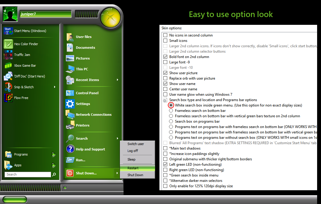

***THE EASY SOLUTION***
If you just want to try out the skin without all the extra settings,
just set the "Search box type and location and Programs bar options" to "White search box inside menu".
THIS IS THE ONLY OPTION THAT WORKS FOR USERS WITH IN-BETWEEN DISPLAY AND ICON SIZES.

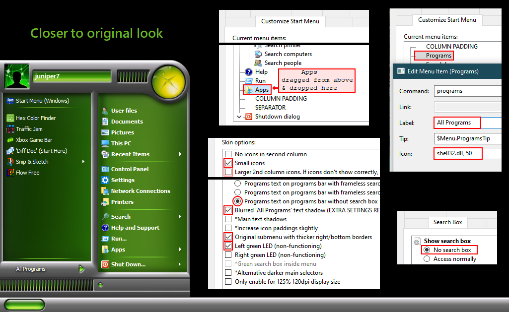

For anyone with more time wanting to toy with the other search box, All Programs, bars texture locations,
I've added a display picture in the next post with the similar original look
with all the settings required in Skin options, and the general settings tabs.
For most of the other menu looks, the search box is usually enabled.
Any option that has programs text on the grey programs bar has to use small icons on the left column.
The other options can use small or large icons on the left column.

The issue with replicating an XP type start menu is there was no search box and the All Programs selector
had its own small size/area to fit on a programs bar, which Classic styles can't have.
As mentioned earlier, to get around that, an option that has text placed on top of the grey programs bar,
one needs to select "Small icons" skin option.
I did try having an option where the programs bar was made big enough to accommodate large icon size selectors,
but it looked so enormous that I skipped that look.
The Windows 10 "Apps" shortcut gets in the way too.
You need to relocate the Apps location somewhere in the second column.
To do that, open the "Customize Start Menu" tab, then drag the "Apps" item to a lower area, for example in-between "Run" and "COLUMN PADDING".
Any skin with a User picture option.
Just a reminder about the bright lines that Microsoft adds to the top and left sides of the user picture image.
To get rid of them, select the "General Behavior" tab, go to the "User picture" option, and set your picture location.
Only works with .png or .bmp images, not .jpg. You will find that your image looks sharper than the default way.
