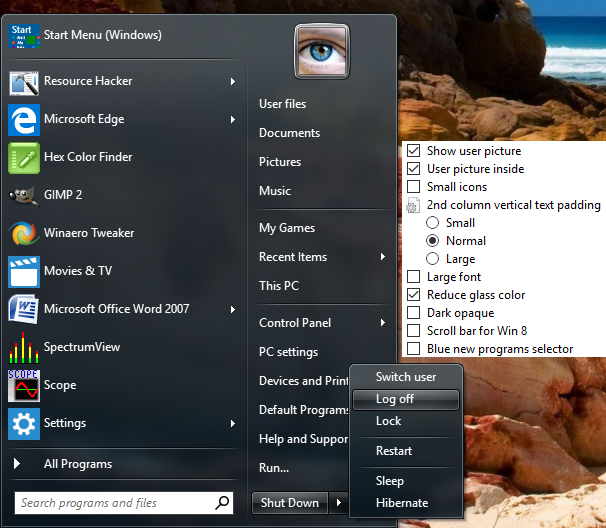

Smoked Glass [7 style] for CSM ver4.3.0
Clearing out my locker, so to speak,
I found a nearly finished "Smoked Glass" [7 style] conversion skin.
I just had to make a bigger Hidpi user picture from the classic style. Done.
This skin works similar to original classic style skin.
On Win10
The trick to get the greyer look is checking "Reduce glass color" skin option.
To get all the color out, go to "Menu Look" Tab and set "Glass opacity" to "0" or,
uncheck "Enable menu glass" option. That will switch on Ivo's modified alpha opacity look. :)
If you want darker still, pick "Dark opaque" skin option that sets menu opacity to region.
Can always uncheck "Reduce glass color" and use "Override glass color" option to use the color picker.
EDIT: Added Smoked Glass revB.skin [Classic1/2]
Not sure if anybody wants an updated Classic 1/2 Smoked Glass skin with the bigger user picture for Hidpi.
In some conditions, the original skin shows horizontal streaks on the menu.
I used Ammonia D (dither noise) to reduce those streaks, same as on the 7 style.
For some reason, the original skin has font -10 on main with small font -9 on submenu,
as the default look with large font turned off.
I made the main -9 to match sub.
If anybody wants like original skin, I can upload. Just let me know.
See a few below posts below to see a picture of streaks. :)
EDIT: Whoops! :oops:
I forgot about the bug where the programs tree box does not show correct brightness level,
when "Glass blur" not available on Windows 8/8.1
This option patch sets the Programs background from "transparent"
to a specific hex value.
Skin.7 upgraded to revision B
EDIT: The Classic style is now revision C due to 2nd column separator was not showing on HIDPI
Smoked Glass revC.skin [462.5 KiB]
Downloaded 4090 times
Smoked Glass revB.skin7 [330.5 KiB]
Downloaded 4539 times
