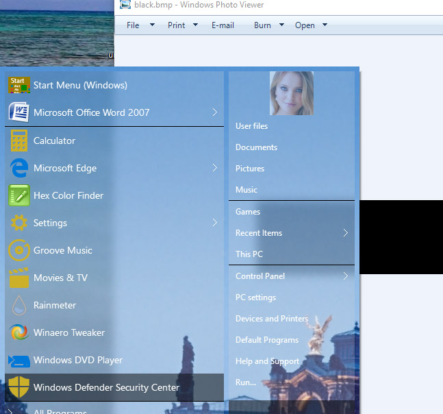

PostPosted: Thu Jun 01, 2017 9:42 pm
Screenshot link is broken, or something.
No big shutdown ok :lol:
I'm trying your skin now.
The search box looks big already.
Unless you mean you want the white part with the S included on top.
If so, requires one or more Search_background, and Search_background_mask bitmaps, and a whole lot a text.
Patterns or emblems, it's up to you.
An emblem shows once. A pattern, once it runs out of image, it repeats itself again and again.
There are a number of ways to get the image to show through.
The actual image has like, say 150 alpha transparency in it, or the emblem1, or pattern1 mask could have 150/255 red.
The mask could have 150 alpha. It's all going to mix. Could even have original menu bitmap at 0 alpha, then the pattern mask, or image takes over. I have not tried all the ways.
Black is usually to block the image. Red relates to 1. green is 2. Blue is the pattern3/ emblem3
In the end it's the final alpha that Windows sees from CSM program that makes the blur.
It's funny. The alpha layer does not blur. I guess Windows adds another blur layer.
Take a look at blown up screenshot of Groove music player.
Windows added random dither noise to the alpha channel, for an artsy look.
You can see all the little pixels dots. Also see there is large blur radius behind.
I started to play with your skin. A user picture can not stretch.
I think on 7 style it has to use User_mask instead of a User_bitmap, to see desktop.
I put the User_mask bitmap at 128 alpha. It came out too milky.
Increased Main_bitmap=1 to 64 alpha. I'm running out of playtime. Will check back in a day, or two.

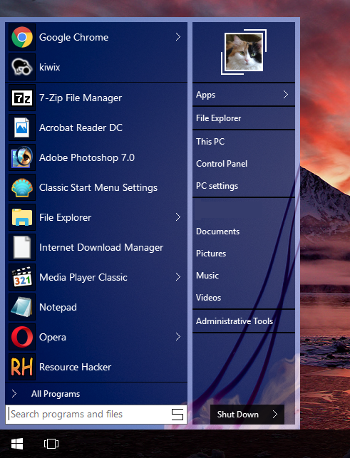

PostPosted: Fri Jun 02, 2017 9:14 am
Posts: 90
Yeah, You are right. All the alpha channels are blended together and resulting alpha is used. While what I want is that Background Image should be opaque And the white pattern behind the menu items should be of translucent and remaining spaces should have heavy blur. But, to do this, each individual image should have its own alpha and glass settings.
Later in the day, When i was continuing the work, I got an idea. Instead of classic shell (/Windows) make the desired blur, I added the blur to the image i was using as a pattern in photoshop. And made the white background behind menu items opaque and then adjusted the mask. It turns out to work and basic idea behind the skin is seem to nearly fulfilled.
But it has a major drawback, we can't use any image directly, instead we have to add blur before. But i think this can be solved if we can get another pattern for only the blur and adjust the mask settings.
But then another problem turns out, due to blending of two patterns, menu transitions become slow and starts lagging. (This might not be a problem and is happening on my laptop due to slow hardware, although I don't think laptop's hardware is that much slow, Try it on your PC).
And also, I am currently using pattern for imaging which is quite good but i think emblems can serve the purpose well for adjusting the alignments. But a problem is appearing there. When I edit the skin file to use emblems to mix two images or to use a mask (see in the skin file, It is at the top and commented out), and then saves everything and blah!! blah!! and then clicks the start button to open the start menu, explorer.exe (windows shell) stops responding and restarts. I don't know why it is happening. Also if i tried one image, everything is fine. Any Ideas??
So below is the revised skin file and menu settings and a screenshot. Although i have edited the skin thoroughly, it needs some more edits and a couple of new features which I will try to add tomorrow.
OK hope you try it.

PostPosted: Fri Jun 02, 2017 11:01 am
Hi.
I don't know if there is any kind of image that can blur like a real piece of physical diffuse glass, just by putting behind.
It would have to scatter the light going through it in different directions. Need a program to do it.
Alpha blending slows down menu operation. There is a note in the skinning tutorial about it,
and ways to reduce it. If I understand it correctly, the actual picture should have the alpha transparency,
not the pattern mask. I have only noticed animation slowdown with 150% DPI setting in CSM.
Now we know why Ivo didn't have pattern feature for submenu. It puts too much stress on graphics processor.
I don't have time to look at your files. Whenever I get the menu crash and restart explorer,
it was my fault. :x
Turn on "Report skin errors "in CSM settings. Sometimes a window will pop up saying what the error is.
Most of the time is a mismatch of bitmaps used, a wrong dimension, or maybe trying to use a pattern mask,
when it should be an emblem mask? I'm amazed sometimes that even when I intentionally leave mismatches in,
the program can still work. Which reminds me, at some point, I have to fix a bitmap mismatch in the Bare Glass skin. Sometimes turning off all skin options can narrow down where the error occurs.
I don't remember if I mentioned this already about shutdown button, oh no, that was about the its color mask.
Um, if you want to make the shutdown button invisible, unless hovering, make the top 1/3 of shutdown bitmap
with 0 alpha.
Also, are you aware a 7 style main menu has 3 bitmaps?
main normal view, search view, and jump list view.

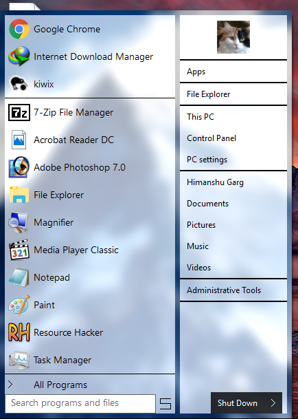

PostPosted: Fri Jun 02, 2017 9:44 pm
Now skin looks like Crystal.
Looks good.
I think text is missing for List split selector.
Maybe you wanted it that way as it's hard to see the pin image.
You could borrow a bigger pin bitmap from another skin, along with its text.?
Yeah, something weird going on if emblem turned on. Maybe picture emblem is too big for middle position logic?
I would put everything on default 0 padding with Left Top position. See if that goes normal.
I read somewhere that's where it starts to draw it. From top left corner.
Sometimes these problems can take 15 minutes to fix, sometimes hours. I'll let you go for it.
If it works, great, if not, and since there is no texture on the 53 image, you could just reduce its size to a few pixels, and use as pattern for program to draw bigger.
About search, and jumplist bitmaps pattern masks, emblem masks.
Wasn't sure you knew. If you do add a bitmap to extend the right side of search box,
more pattern/emblem masks might be required.
Have I been drinking too much ginger beer?
I see double images on above posts. I kept looking back and forth for differences.
Yes, the difference is uploaded picture, and linked picture?

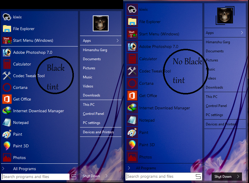

EDIT: I was thinking after posting.
Maybe you don't even need image 53.
If all you are doing is adding a mix of non textured white using the green part of the regular main mask.
Could just make the green value like 200/255, or something referenced to white as a tint.
Main_bitmap_tint1=#000000
Main_bitmap_tint2=#FFFFFF
Main_bitmap_search_tint1=#000000
Main_bitmap_search_tint2=#FFFFFF
Main_bitmap_jump_tint1=#000000
Main_bitmap_jump_tint2=#FFFFFF
No, I did not try it for real, only in head.
EDIT: Again last one, really. :)
Now you got my curiosity going. I had to see what happens.
Imagination in head does not always work out in real life. :lol:
That text didn't work, for getting rid of pattern 53.
And I see you have a mix in the slits part already.
I tried a different approach, which appears to come out linear looking.
Only have icy crystal mountain picture as pattern.
Have main bitmap as white opaque, opacity region. (So brightest base as possible)
Have pattern mask 255 red, with 96 red on the slits part. No green.
The light and dark parts of menu are not as dynamic looking as yours,
as when pattern 53 white image is used. Funny, I wonder why? It must clip/over expose in some way?
I better get back to my other work. Bye

In case you are interested in a wider search box with your "S" inclusive,
here you go. The zip has the matching bitmaps to install.
Goodnight :)
Search_padding=0,0,0,0
Search_frame=0
Search_background=32
Search_background_mask=33
Search_background_slices_X=0,1,1, 0,13,4, 1,1,0
Search_background_slices_Y=0,1,1, 1,2,1, 1,1,0
Search_background_padding=0,0,0,0
Search_background_search_padding=0,0,0,0
Search_background_jump_padding=0,0,0,0
;Search_hint_font="Segoe UI",italic,-9
;to block pattern image showing inside search box
Search_pattern_mask=34
Search_pattern_search_mask=34
Search_pattern_jump_mask=34
Wider Search box.zip [887 Bytes]
Downloaded 5653 times
I better get back to my other work. Bye]
Yeah, I figure it myself before reading your post and also had tried it and it worked.
For the first case about tint colors, it may had not work because I think mask is not active and is commented out. May be, I am not sure as I am through editing the skin and had left the above uploaded file far behind.
For the second case, I had done this and now I am using it. But I haven't noticed the difference in the look with and without Patterns 53 before but Now I do. I will try to figuring it out and try to devise some new way.
[In case you are interested in a wider search box with your "S" inclusive,
Goodnight................]

PostPosted: Mon Jun 05, 2017 5:39 pm
Here is another picture to help understand all the slices, in this case, for taller search box.
TALLER WIDER alternate search box
If you absolutely want a taller wider search box, it becomes more complicated.
You see, the vertical size of search box changes with the main font size, or dpi.
which you have at -11 already. I don't think it can get any taller.
Upping the search hint font will only cut off the bottom letters.
I don't think text "Search_text_padding=1,6,1,6" can even work in search box.
An extension part of search background would need to be added, that could trick it.
You see, in a normal Win7 menu, there is padded white space around the search box.
That is what those extra slices, that Ivo put in, are for.
Those extra slices are for the outside of the search box area, where you can increase the Search_padding.
In this case, putting the box line on the outer slice edge along with altered slices and padding text,
we trick it so the outside is part of the inside. :)
It needs a whole new set of matching bitmaps to use.
other
MAIN BITMAPS
Was just asking, as it was your first skin. :)
I wasn't sure you knew at the time, about the all main bitmaps, which led to even more pattern masks. and more.
Back when I was helping out shpkong with his skins, we learned about having to use pattern mask for the 7 style search box, in a certain circumstance.
UPLOADING IMAGES.
Everybody else seems to use Imgur. I did for awhile, then links went dead.
I don't think Ivo minds a direct image upload.
I try and keep mine no bigger than 1 meg, usually around 100k size,
so it doesn't affect page loading.
SCROLLBAR
I'm on Win10 Creators update, that broke the skinning of scrollbar, and taskbar, from working.
It might be difficult to explain it.
Best to look at the skins that have it.
There seems to be two ways of having directional arrows on the end buttons.
Either use an arrow bitmap, or integrate them into the end buttons.
That's all.
Good nightynight.
Tall and Wide search box.zip [1.05 KiB]
Downloaded 5564 times

PostPosted: Tue Jun 06, 2017 7:37 pm
Posts: 90
Hello Juniper7, Below is the skin which is nearly complete.
Only three things are remaining:
1] Although I am testing the different options, I am not confident that there might not be any miss. So, can you please test some of the features especially Submenus and jumplist related as I don't use these features in daily life.
2] Any other recommendations
3] I have not adapted this skin for High DPI displays because I dont know how much Percentage is used. Can you do it for me. Or I have an Idea That I will borrow Percentages for other skin files, But don't know that it will work or not. Will It?
OK, When You said OK , I will make a new post for posting the skin.
Try it and tell me How it is?
SKIN AND MENU SETTINGS.zip [1.65 MiB]
Downloaded 6303 times

PostPosted: Wed Jun 07, 2017 7:25 pm
It takes a lot of work to put in so many options for a picture start menu. Less than a dozen have made one.
I like the asymmetrical circle user picture frame.
You've got to be the first person to put so many color pickers for options.
Spelling mistake in skin options Use white Seperators to Separators
Shutdown white arrow and white text not visible on white shutdown selector sometimes.
Might have to omit in that location (black always),
or show black only, if "Show Colored Background Pad" not picked?
I have to say, this happens only when your xml settings file is not loaded.
Beats me about using someone's picture. Could put a reference in your post, the link of where you downloaded it,
or thanking the artist by name?
I did not catch anything odd with jump list view.
Similar issue with the white arrows on white submenu, if xml not loaded. Maybe make a separate submenu white arrows option, or have show black ones, if submenu background color option not picked, or do nothing at all?
Any other recommendations? Aw, I miss Crystal mountain. It was pleasant to look at.
Probably picture too small, and would start to tile repeat on Hidpi.
High DPI. In most cases, it's not worth it, scaling up another batch of menu bitmaps.
The smaller the border, the less noticeable it becomes.

PostPosted: Sat Jun 10, 2017 12:43 pm
Hello
All I did was add the arrows, and user picture parts as png images(to save some file size),
and add the HiDPI text at bottom of script.
At 144 DPI, the arrows are larger, but they look thin next to thicker text.
You might want to thicken up HI-DPI arrows? I think it's due to the busy jellyfish image.
Also on 144DPI. When you moved the jellyfish image to left in new version,
jump list view now shows end of picture, then repeats. It looked fine (no tile repeat), on last version.
Maybe put both images in skin file(file getting bigger). Then 100% reg size assigned to use latest modded image, and assigned under HiDPI to use the older image?
I never noticed before, but the glass and transparent throughout option,
only works if "Show background card color" is checked? Something odd with text logic, or you wanted that way?
About user picture. I notice on reg size, that the square black frame has transparency.
all the rest of bitmaps have opaque frames? Which looks better? I don't know.
If a user picture is black, you will see a brighter top/left pixel line. Barely noticeable with detailed picture.
If you don't want line to show, one way is to hide edge of picture behind an opaque frame.
example on reg size:
User_image_padding=10,10
User_image_offset=7,7
User_image_size=50
change to
User_image_offset=6,6
User_image_size=52
Note. The round user mask would need to be bigger size too.
I see on the hidpi round frame, you already did something like this,
where frame hides a little bit of user picture.
Handing back to you for possible further processing. :)

PostPosted: Thu Jun 15, 2017 9:40 am
Posts: 90
Hi, I take a look at your skin.
Yeah, you had make transparent menu by using Main_bitmap, patterns and masks.
But, My skin can do that too.
The problem arises only when "Show background color" is not checked.
As your skin haven't that option, the color in the Main_bitmap or in the pattern is used all the time. (which is black).
Look below at the picture.
In the left, it's your skin having black tint in the middle portion
To the right is mine one, having no tint, it is original jellyfish image color. (When "Show Background Color" is unchecked)
These tint colors can be confusing. I got myself confused many times when writing options in the skin file.
Here's a little equation which helped me:
Showing original pattern(Image) color = Not showing any color ≠ Showing Black Color
Might this help you.
Difference in the central area (Left is yours and Right is mine).png [ 869.38 KiB | Viewed 388550 times ]

Hi meetHG and juniper7, lovely to see your skinning efforts. juniper7 is a skinning pro who has made some superb skins, some of them are better than even the skins shipping in Classic Shell.
Anyway, this is how your skin looks at high DPI. There are 2 screenshots. (Btw superb job with the way the custom image background is shown for the skin). :)
Let me know if you want a screenshot with some specific skin settings.
Some of the icons in the submenus and in search results touch each other, so you might want to increase their padding/spacing a little bit. Also if frames are enabled for submenus, they touch each other.
Also, the Shutdown button's arrow part could be bigger and have a separator from the left part (since it's a split button). In fact, the jumplist buttons could also be bigger and get a separator.
Hi DPI.png [1.86 MiB]

I take a look at the screenshot.
It was hard to view the image. Two times I tried to download but failed at 92%.
Then, simply viewed with the browser, still lower part don't show up.
No matter, Most of the menu showed up. I take a quick look.
It looks fine, although arrows seems to be little "little".
What do you think?
I noticed the submenus.
Yeah you are right. Icons seems to get into each other.
I will fix this one.
Same with search results will be done.
For shutdown and split selectors (jump buttons), do you want to increase the size of the second part where the arrows reside or the arrows itself.
Also, they do contain the separation but it is only 2 pixel wide so may be hard to see it.
No matter, I will fix this one also.
Thanks

Wow! First image don't showed up earlier: only after coming from the above reply.
Few second to analyze the screenshot.
EDIT: Taken a look, looks OK.

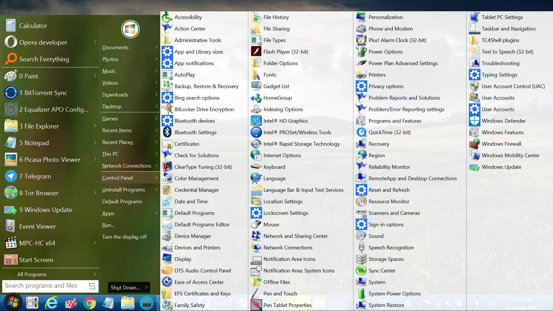

Below is the screenshot in which it looks like Metro (although some icons may be different like that of All Programs)
For this you have to set some settings as shown in the side picture.
