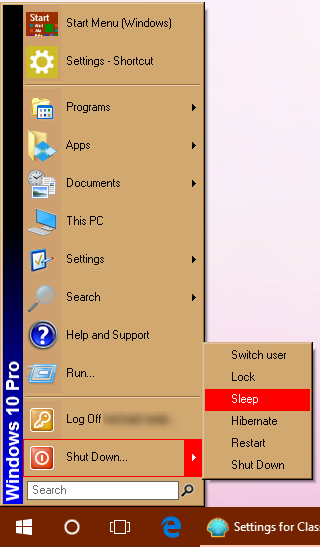

PostPosted: Sat Sep 03, 2016 10:24 am
Here is what I made so far for the baseball color in Win 98.
It has built in color, not a theme color, using on normal Win 10 system theme.
Only 16 more color variations to go.
I'm thinking to copy what you did with a real picture of win 98 caption.
That will make it look more original. Will have to figure which way is better, picture built in,
or picture as emblem, on top of menu?
If all works properly, I should be finished skin in less than a week.

PostPosted: Sat Sep 03, 2016 12:02 pm
Hi R.O.B.
Just one more question.
For the built in colors variation in first tan picture,
I copied icon bar effect. I used Ivo's icon frames, without a gap in between.
I cant make it work in sytem variation though. Don't know what it references to.
Do you happen to know what $ ??????text
to use in your variation?
