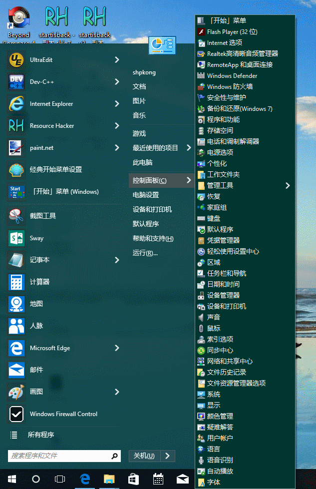

I am trying to make this skin like startisback's plain10 style (which is my favorite style) .
But I failed to add fullgrass effect to submenus as it is to the main menu.:roll:
May I ask how to add transparency to sub menus in classic shell?
In the .skin7 file, I have already removed all my false attempt to make the submenu transparency.
test.skin7 [185.56 KiB]
Downloaded 4432 times
PostPosted: Fri Aug 05, 2016 8:22 am
You need "Submenu_opacity=fullglass".
Take a look at the SmokedGlass skin for one example

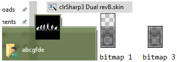

PostPosted: Fri Aug 12, 2016 9:02 pm
More on the user picture 1/2 out on Classic skins.
Here is another link from a persons skin that is simple to understand.
viewtopic.php?f=17&t=5785
On this one, the glass blur works,
because it is square user picture frame, without the almost transparent pixels that make the artifacts.
Even shadow works well.
Take a look at clrSharp3 Dual revB.skin from the Zip.
To show picture half out. He made invisible part at top of main bitmap. See bitmap 1
When no user picture is turned on, a smaller bitmap 3 (without transparent top) is used.
The vertical slices and padding are different for each bitmap.
no picture
Main_bitmap_slices_Y=23,9,9
Main_padding=12,26,6,12
Main2_padding=3,26,6,12
with user picture
There has to be more pixel height and padding to make up for the invisible part of bitmap.
Main_bitmap_slices_Y=48,9,9
Main_padding=12,51,6,12
Main2_padding=3,52,6,12

I see.
Maybe it is because do not know very well about the alpha channels.(why you call it alpha?:) )
I use PS to open the bitmap 1 in John's skin, may I ask whether is black related to full trans(not able to see).
Sorry for my English.
PostPosted: Fri Aug 12, 2016 10:04 pm
I'm not sure why it is called Alpha. You could look on a search engine site.
Alpha is one of the channels that a 32 bit bitmap can have.
red 8 green 8 blue 8 (alpha transparency) 8 = 32
Just like red can be almost black 1/255 with a little red, or very red with max 255/255
So can the transparency channel from totally invisible 0 to totally not invisible 255/255
Not all bitmaps are 32 bit. Some are only 24 bit, with just the red,green, blue, no alpha.
Not all image programs can import/export 32 bit bitmaps.
I think your one does.
It could show up as black or white, or checkered.
Usually there is an option in program to change what the transparency channel looks like.
There must be an eyedropper or some tool that gives alpha value. Go into help file if can't find it.
