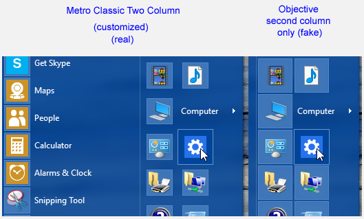

I wanted to have the second column look at bit tile-ish, by changing in the customize section,
as well as changing the Main icon frame colors text in the skin.
Ran into a couple of snags.
1.
Is it possible to have the second column to have a different color icon frame?
Won't accept Main2_icon_frame_tint1=
2.
Is it possible to increase the Main2_icon_frame_padding?
Program does not accept.
In the combined picture, the left is what I have right now,
and the right mocked up version of what I am trying to acheive.
Just only the right column, I want to brighten up by having
bigger icon shortcut tiles.
Any hints? :)

Ah. I think I figured out the logic.
It's like you can't tell it to say have "Octopus wearing a Timex watch",
because the Octopus, and Timex watch did not exist yet!
They need to be created separately first. :)
