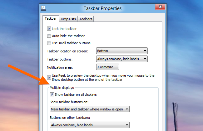

Just wondering if there was a way to duplicate the ClassicShell program bar across my screens.
If I slect "Never Combine" on my main screen, it still show the default "Combined" mode on my secondary device and not what I selected.

I am not exactly sure what you are asking. You are talking about "Combine" and "Never Combine", which are settings for the taskbar. However Classic Shell doesn't do anything with the taskbar.
PostPosted: Sun Sep 29, 2013 7:37 pm
Classic Shell does not affect the Taskbar besides adding a Start Menu. When you connect additional monitors on Windows 8, you get extra settings to configure the always combine/never combine behavior for the additional taskbar. They are in Taskbar Properties in the Control Panel.
