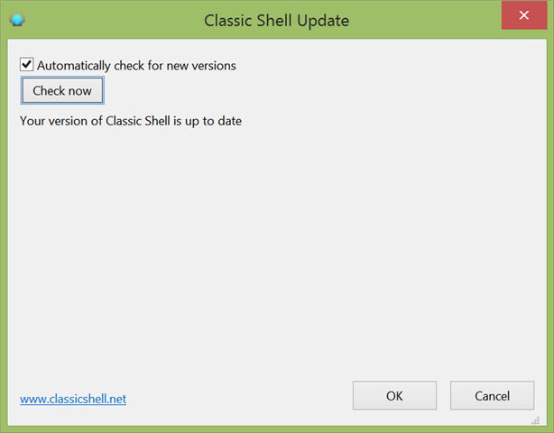

I downloaded ver. 4.3.1 yesterday, and it seems to work perfectly. Today, however, I thought to double check it by clicking on "Classic Shell Update." The response I'm getting is "Failed to check for new version." Everything else seems to work, but what's up with that reply? Is it a bug in the program, or is it just something peculiar to my system?
OK, now I've just downloaded 4.3.1 on my wife's computer. Windows 10 like mine, but otherwise a completely different CPU, hard drive, etc. Same thing. The new version downloads and apparently installs properly, and then appears to run perfectly. But when clicking "Classic Shell Update," I get the same response: "Failed to check for new version." I don't think it's anything on my end.
PostPosted: Tue Aug 22, 2017 11:11 pm
That means Classic Shell Update is unable to access the internet. Your security program or Firewall could be blocking it.
It says this when it can connect to the internet:

Thanks, Gaurav; I'll check my firewall settings. However, unless Classic Shell itself changed the settings on my computer AND my wife's computer, the settings allowed Classic Shell to access the Internet just moments before the update. That's how I knew to download the new version of Classic Shell: because the Classic Shell update page told me there was a new version, and I downloaded it from there.
