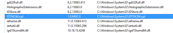

PostPosted: Thu Jul 13, 2017 9:38 am
I hate to say it, but you still have the file "C:\Windows\System32\IDTCN64.cpl"

PostPosted: Thu Jul 13, 2017 3:00 pm
Do you happen to have the IDTNC64.cpl file in C:\Windows\System32 folder? If so, rename it or delete it.

PostPosted: Thu Jul 13, 2017 5:15 pm
When the start menu launches it collects all items from the interesting folders (icons, names, etc).
I think you can get the same crash when you simply view the Control Panel in Explorer.

It might be helpful for others -- Renaming IDTNC64.CPL wasn't enough
I REN'ed IDTNC64.CPL to IDTNC64_BAK.CPL.
Rebooted and it continued to crash.
DL'ed windbg and did my own analysis (you guys had done enough !), and while I don't claim to know what I was seeing,
IDTNC_BAK.CPL was clearly being highlighted as a problem.
MOVED IDTNC64_BAK.CPL to Documents, rebooted and now working.
Thanks again !

If you'd renamed IDTNC64.CPL to IDTNC64.CPL.bak it would have worked first time. Because you left the file in the system32 folder with a valid control panel file extension, it still caused an issue.
Worth noting for the future. If you're going to rename a file, change the extension. If you leave it with a valid extension, like dll, exe, or cpl for instance, it's still a useable file that can get loaded whether you like it or not.
PostPosted: Wed Jul 26, 2017 11:10 am
Besides IDT, there is ONE MORE driver that I've found which crashes Control Panel. Realtek's audio driver if you haven't updated it, contains RtkAPO.dll which has the same effect as IDT's CPL file.
