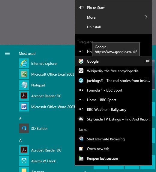

Just to be clear - I'm attaching some screen-dumps.
ScrDump1.jpg is my Classic Shell jumplist. These links don't work, as indicated in the original post:
If I click the button at the top-left [Start Menu (Windows)] I get the original (awful) Windows 10 menu as per ScrDump2.jpg. These jumplist entries work OK:
If, as suggested, I pin IE to the taskbar I get the jumplist shown in ScrDump3.jpg, which works OK:
So I think there might be a bug somewhere in Classic Shell. Surely I'm not alone in experiencing this.

 Post subject: Re: IE jumplist
PostPosted: Tue Nov 22, 2016 7:57 am
Got it. So the contents of the jumplist are correct, but the start menu does not launch them correctly.
Send me the contents of these two files:
%APPDATA%\Microsoft\Windows\Recent\AutomaticDestinations\28c8b86deab549a1.automaticDestinations-ms
%APPDATA%\Microsoft\Windows\Recent\CustomDestinations\28c8b86deab549a1.customDestinations-ms
Zip them together and attach them here.
