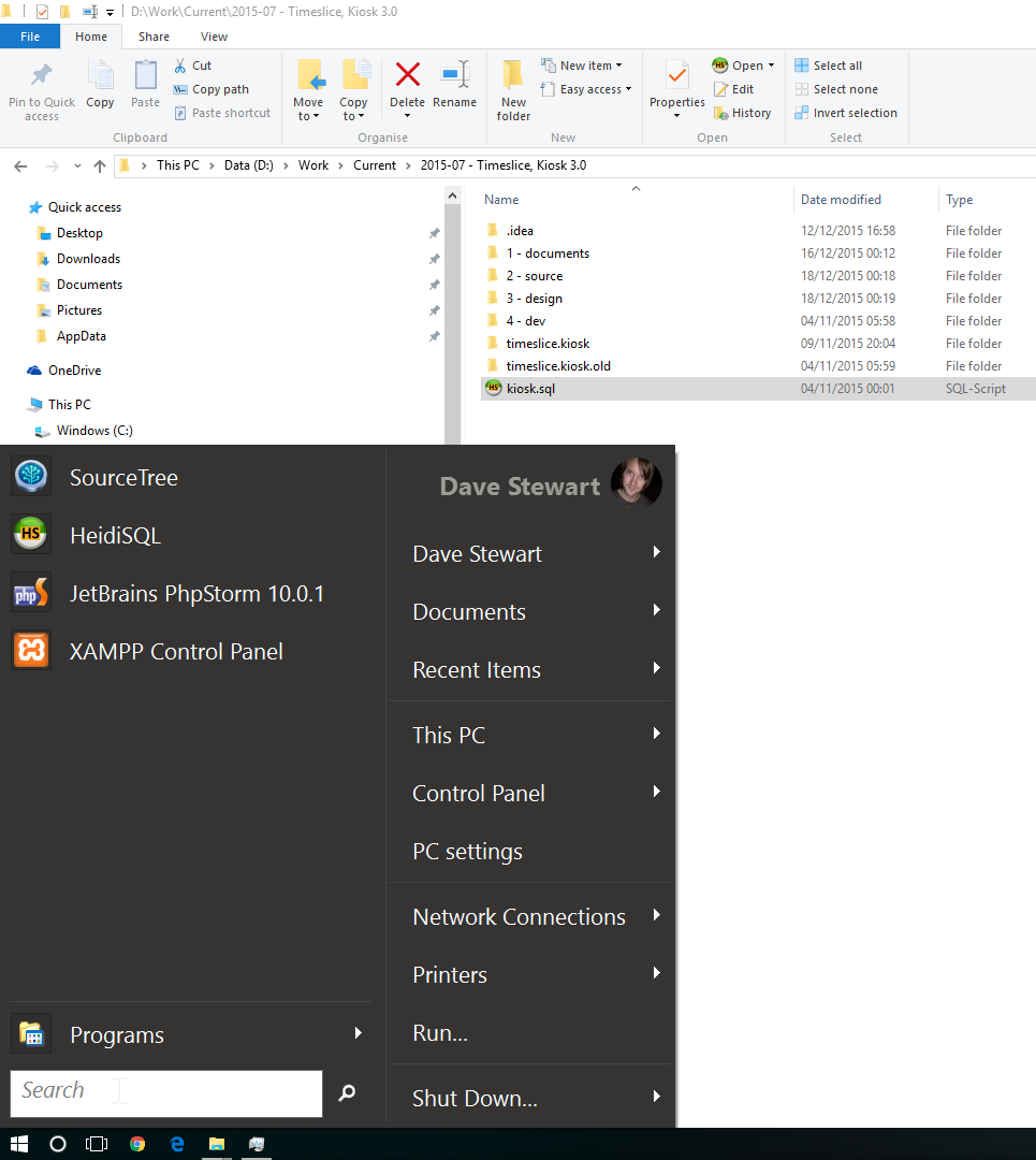

I've recently made the move to a high-DPI laptop with a secondary external screen, but unfortunately, Classic Shell exhibits scaling issues when displayed on the secondary monitor.
It seems to somehow be taking the primary (high-DPI) settings and looks hugely enlarged.
I haven't tried swapping the monitors in Display Settings to see if this has any effect, but I assume that this setup hasn't been considered when developing.
I've also set Classic Shell to use "Disable display scaling" in its Application Properties, which brings some of its own issues (the layout in CS Settings is misdrawn to varying degrees in most panels) though seems to solve others.
Would be great to at least get confirmation on this, and hopefully a fix at some point.

PostPosted: Tue Dec 29, 2015 5:20 am
Are you using the latest version, Classic Shell 4.2.5 released in November? It has new support for per-monitor DPI scaling. The text and menu elements are scaled independently for each monitor. The icon size depends on the global system DPI. Try it without any compatibility settings like disabling scaling in its Properties.
Also, on the Menu Look tab, locate the setting "Override system DPI", right click it and click "Set default" so its value becomes 0. Then restart the menu and see if it scales correctly on the two separate displays.
PostPosted: Tue Dec 29, 2015 5:41 am
Posts: 50
Hi Gaurav,
That's helped, certainly, thanks.
As you say, the icons on the second display aren't respecting the scale of the monitor, but seem to be taking their lead from the global setting. Can this be fixed?
Also, the tooltip text is also much bigger; screenshot attached.
