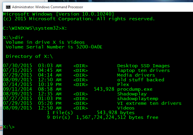

It won't make a dump as the everything reloads I guess, the dump should be in the area I put the tool right?
EDIT: added another pic showing what it is telling as it has no dumps.
