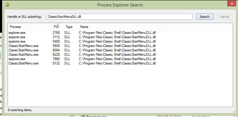

Check with a tool like Process Explorer if ClassicStartMenuDLL.dll is loaded inside the Explorer process for that desktop.

Here you go (I attached a picture of the dll loaded and the processes running)
