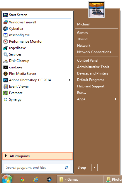

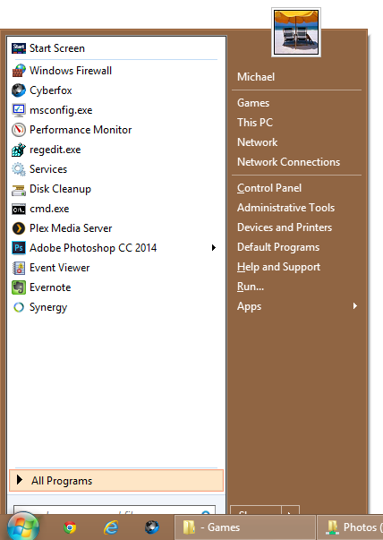

Using the latest version of Classic Start Menu (v4.1.0) and having my taskbar set to "Auto-hide the taskbar", when I press the "Windows Key" to bring the taskbar back up, Classic Start Menu seems to draw the window based on the position of the taskbar when it is minimized and therefore is partially obstructed when the taskbar is restored. (Functionally, it all works. I am able to "Windows key", then type "cmd" (example), enter ... and will bring up the command prompt)
Everything works fine if I just use the mouse to bring the taskbar up THEN click on the start button.

File comment: Using mouse to bring up taskbar, then click on the start icon.
File comment: Using the "Windows Key" to bring up the taskbar.

There is a known bug for auto-hide taskbars on secondary monitors. It will be fixed in the next version.

Thanks! I just logged on to the forum to report that exact situation ... I noticed that it worked fine on my primary monitor, but neither of the two secondary monitors.

This bug is fixed now in the latest version of Classic Shell.
